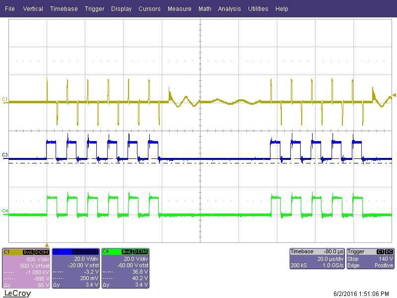

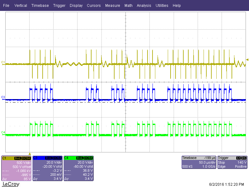

    I ran a quick check on my UCC28950 EVM in Burst mode just now. Some typical screenshots are shown below.
    Yel: Voltage across transformer primary.
    Blu: OUTA
    Grn: OUTC
    I changed the horizontal scale between the two 'scope plots but it is clear that in each burst the power transformer sees an equal number of positive and negative pulses and an equal number of OUTA and OUTC pulses.
    This behaviour is designed into the controller so certainly the OUTx signals at the chip obey this pattern. It is possible of course that something in the gate driver circuit is causing the asymmetry you are seeing.

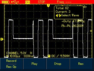

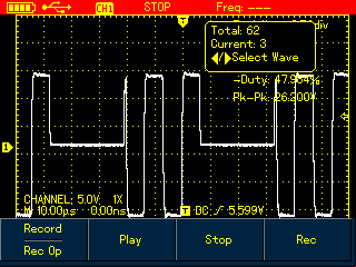

  • As you can see, a very brief pulse is given on MOSFET D at the start of every pulse train. MOSFET C (shown negative) does not have this pulse. This causes the uneven waveform. Exactly the same happens with MOSFET A and B, with A having the erroneous extra pulse, matching up with D's pulse.
