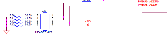

    I am confused with the PMBUS address setting for UCD90160
    The PMBUS addr is set by two analog pins: PMBUS_ADDR0 and PMBUS_ADDR1
    The connection of these two pins in my board is as below, could you tell me what is the PMBUS address with this connection? Thanks

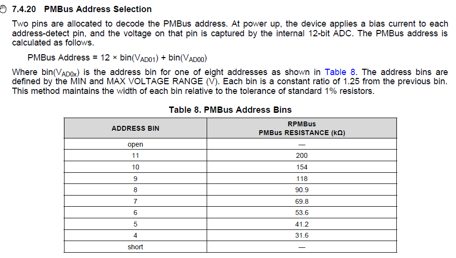

    The related description in datasheet is attached for your reference

  • Hi James,
    The address will depend on your connection of J37 header.
    For example, if we connect 3-4 and 5-6, it is easy to find the address bin for both pin,that will be 5 and 8.
    So the PMBus address = 12*8+5 = 101
    But if we connect both 5-6 and 7-8 under PMBUS_addr1, the resistor is 43.8Kohm. The address BIN is unknow, it maybe recognized as 5 or 6 randomly.

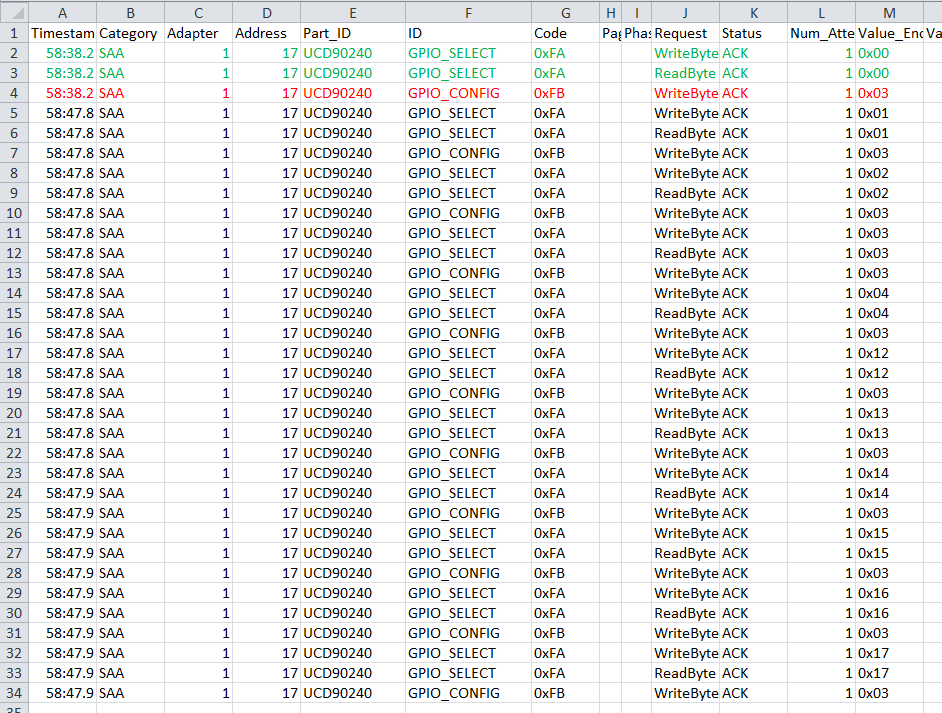

  • Hi James,
    The GPIOs can be to toggled using PMBus command:  (0xFA) GPIO_SELECT and (0xFB)GPIO_CONFIG.
    Please refer to Chapter 10.43 of below PMBus command reference:
    slvu352c[1].pdf
    You can use TI fusion GUI to help on your coding.
    Go to Tools-->PMBUS Logging ,  press "start logging"
    toggle the pin state of below GPIOs from 1 to 0:
    Then go to Tools-->PMBus Logging, press "Stop logging"
    You should got a spread sheet show as below:
    I hope this will help to complete your coding.
    thanks,
    Luke
