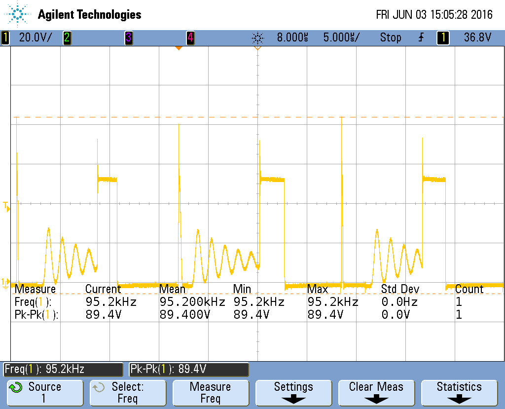

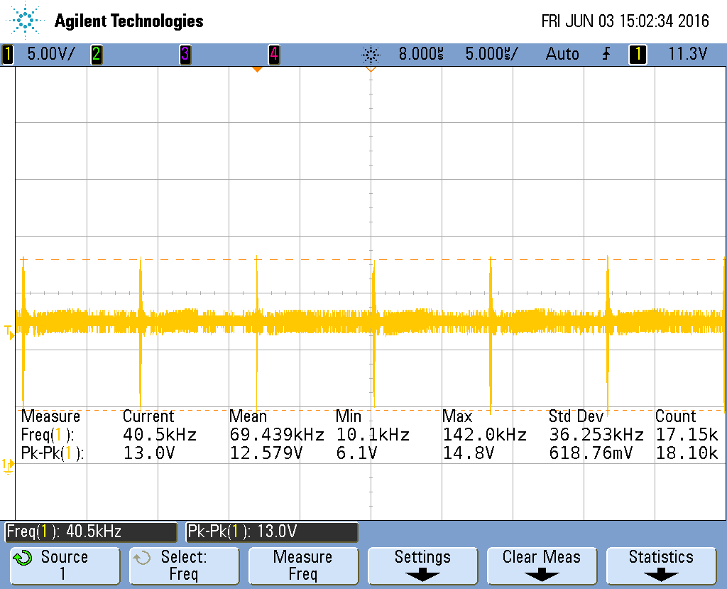

I have a design to take 53 volts in, and regulate it to 12.3V/7A.
My issue is with my switching noise.  When I increase load then the noise increase as well.
And about 4.5A load LM5117 is turned off. I think it's because of switching noise.
Below picture is a SW pin signal and It has switching spike, ringing signal and some skip switching.
Below picture is a voltage output (12.3V) and I can see switching noise.
And I attached a schematic.
Can anyone help to solve this issue?
