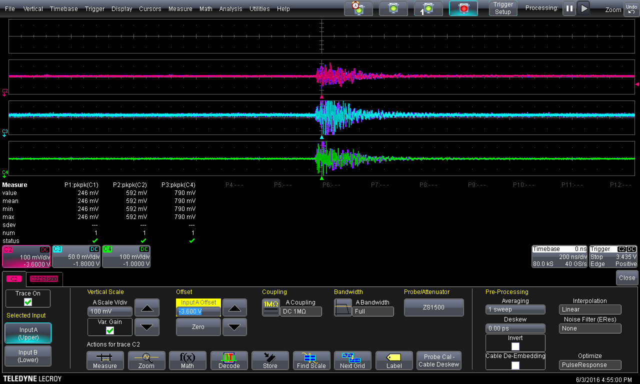

I am getting an occasional drop out on my regulator. I believe that part of the issue is I am getting noise coupled into the feedback path (which is located on the bottom layer of my design). I was able to minimize this by adding a faraday shield on top of the feedback path and this helped quiet my supplies. I am however still seeing the occasional dropout and I wanted to know if I could have someone in your group take a quick look at my PCB layout.

    Vin = 3.3V
    Vout1= 1.0V
    Vout2 = 1.8V
    I captured an event.
    the red trace is my input
    blue trace is my 1.8V output
    green trace is my 1.0V output.
    I can think of two things that might cause this ringing
    1) not enough input cap
    2)layout issue -  possible coupling into my sense feedback line
    Have you seen this type of signature before? any suggestions. This hit might occur once or twice an hour when I am running stress tests on my PCB.
  • I received your email offline. I will request schematic and layout files to help understand what might be causing this noise.
