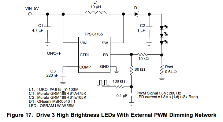

Hi Expert,
Does TPS61162D support external PWM dimming? Any side effect? Thanks!
Yes, the TPS61162D supports PWM dimming. This is one of the two ways to control dimming on the device and there are no side effects associated with this method of dimming.
