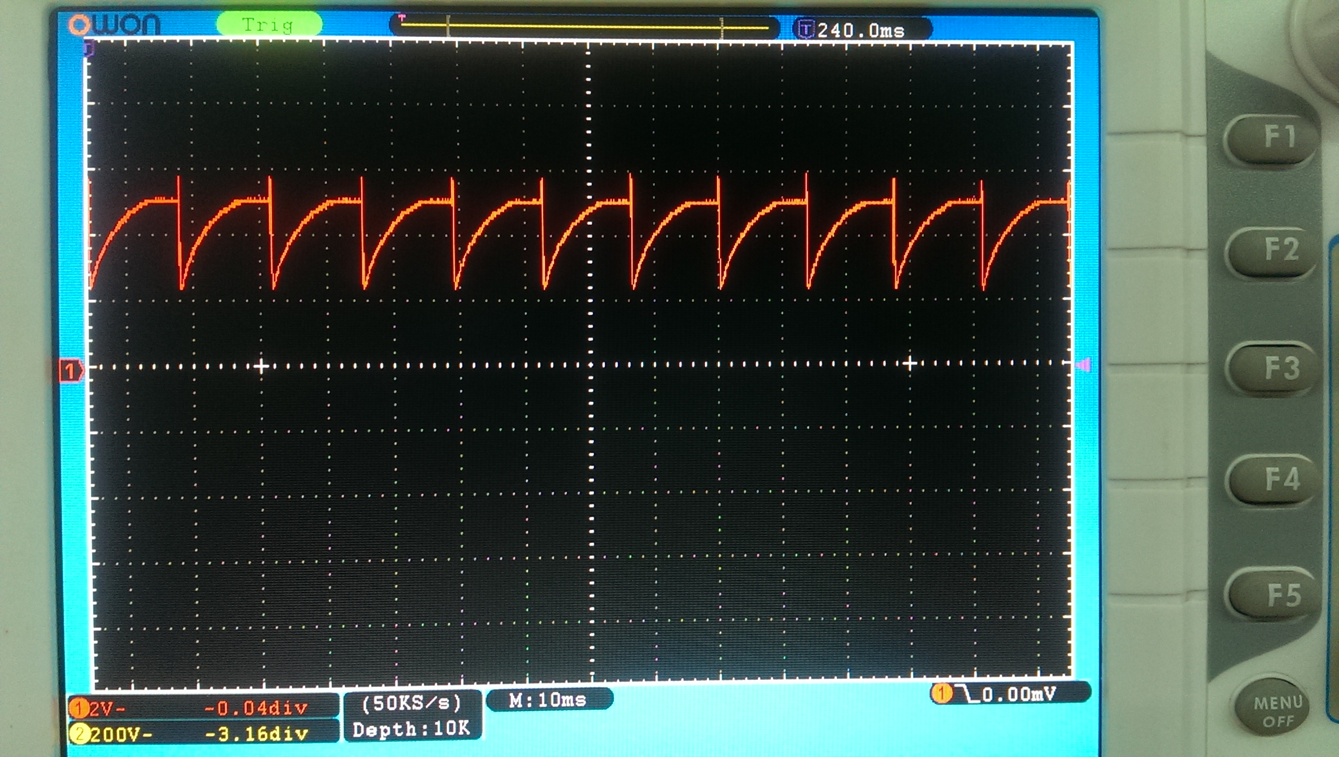

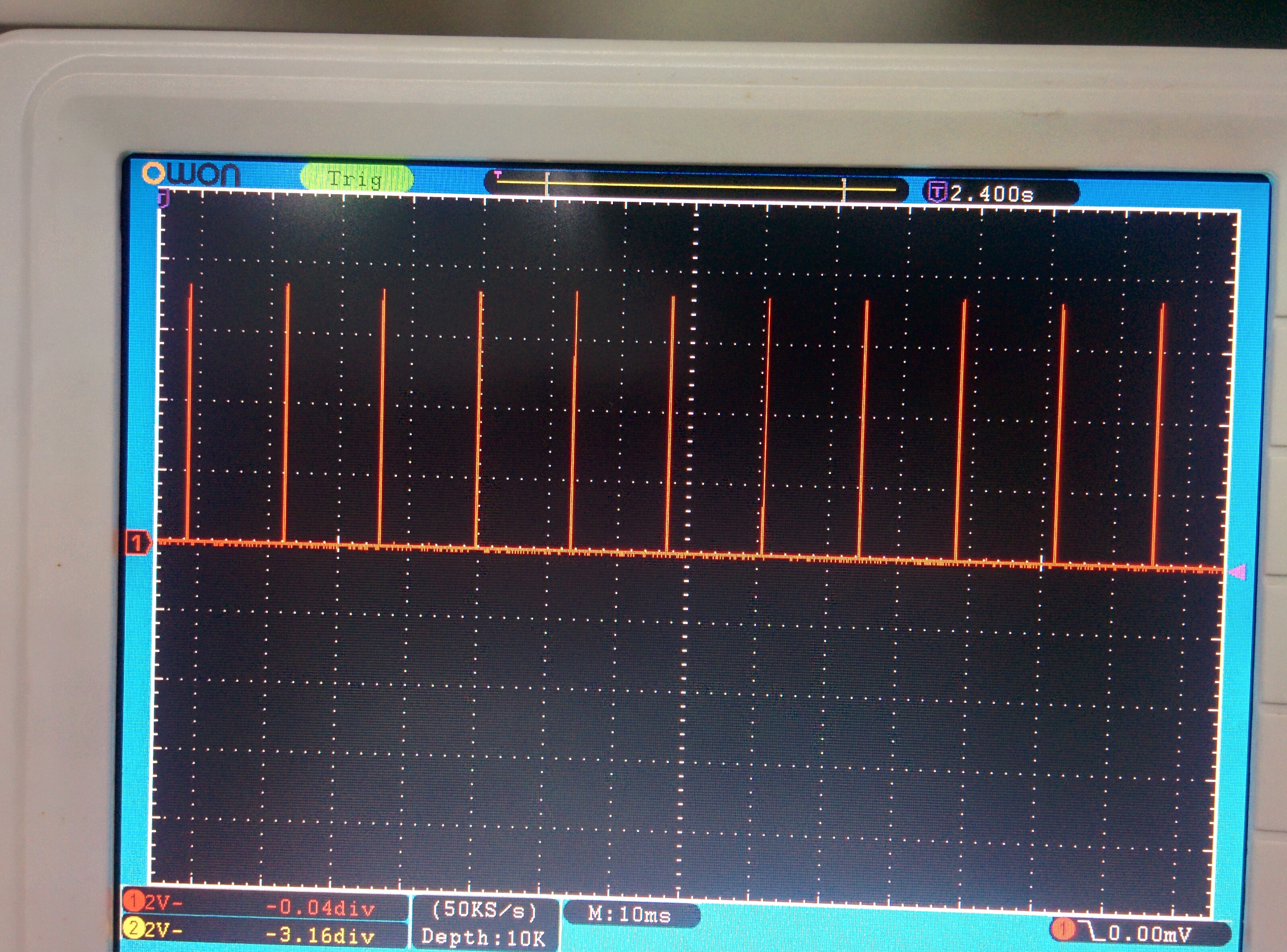

    The voltages at
    EN is 1.96V
    VIN is 11.85V
    VCC is 7.41V
    These are the waveforms at sw1 and sw2
  • This does look strange. The next logical step is to check the following nodes:
    SS: Is it ~1.26V or stuck at some lower value.
    LDRV1 and 2: Is there any gate driver output?
    Since the switch nodes are not reaching ground during switching I suspect that the low side FETs are not turning on.

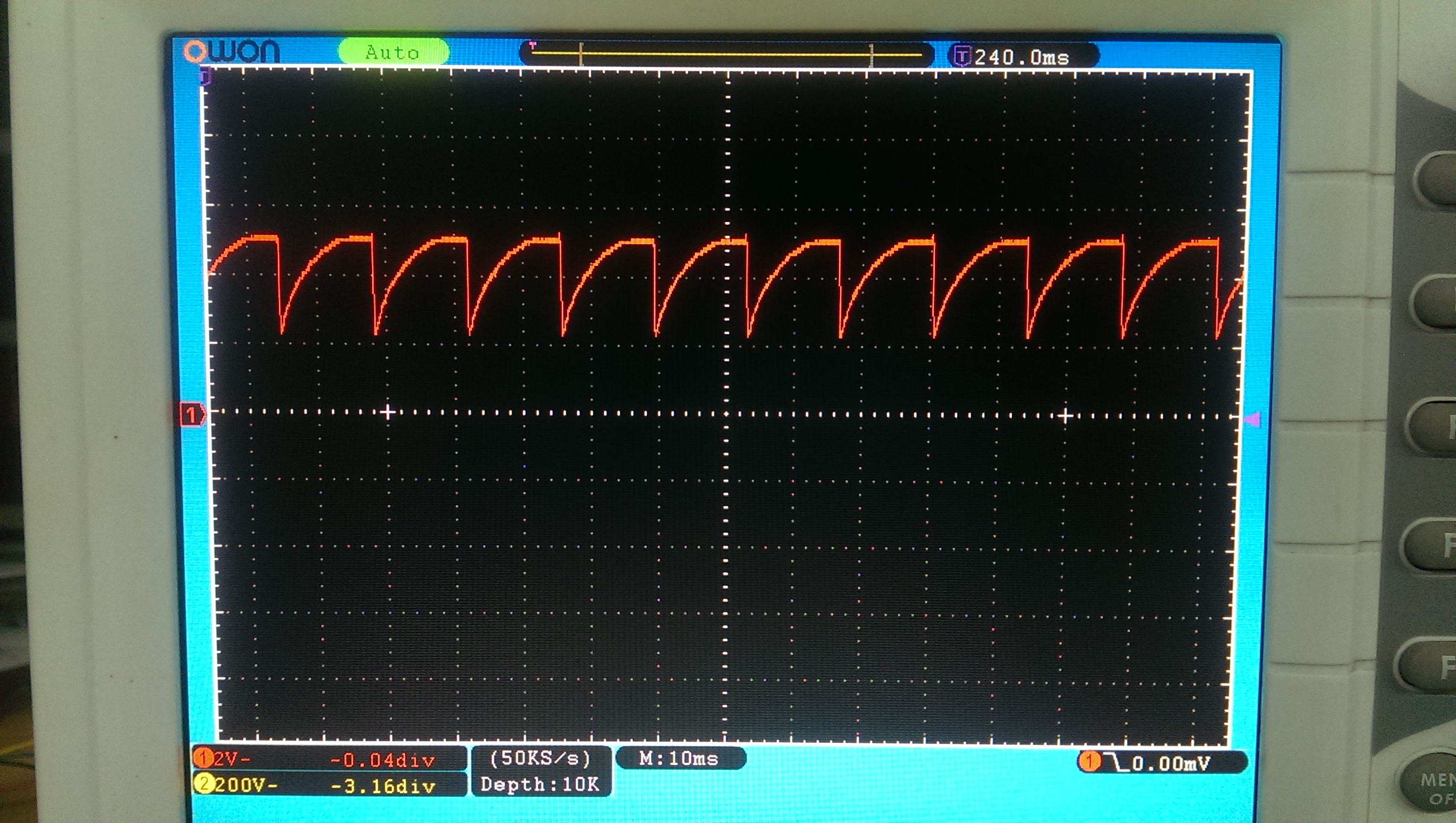

    There is no gate drive signal at LDRV2
    and the signal at LDRV1 is like this
    Something is obviously broken. SS should start ramping up when EN is > UVLO threshold. If all teh connections are ok, I suggest replacing the LM5175 and see if the part was accidently damanged.
