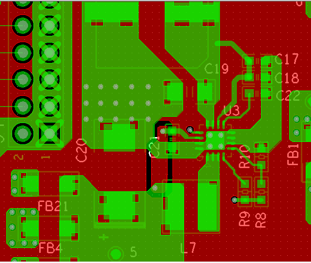

I've used TPS62130 in my board,
all these function (12V to 3.3V,12V to 1.8V,12V to 1.2V,12V to 1.5V,12V to 1.0V) were done by TPS62130RGTT,my circuits is like this:
Sometimes the 1.0V were out of work,others outputs are all functional.
The 1.0V power for FPGA(xilinx 7A100t,2A max was tested by a DC power),the onle difference between ours from your recommended parameters is the value for R1 and R2 resistors.
I found those values are (R1=51k,R2=200K),But I've used(R1=2.5K,R2=10K) for it,the figure signs R1=5.1K is wrong,that value is R1=2.5K.
Could that be an problem?
Many thanks
