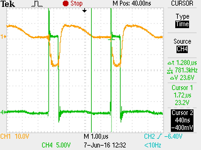

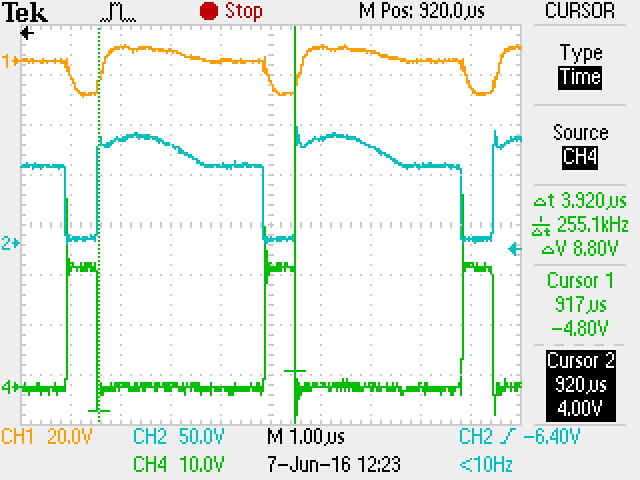

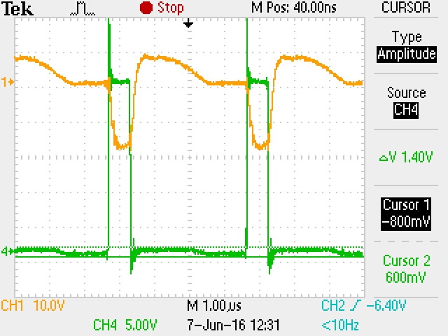

    I am attaching the wave forms of the Vgs and Vds of freewheeling mosfet and Vds of the main mosfet at 75V input voltage full load of 12 A.
    The green, blue and yellow waveforms are Vds of freewheeling mosfet , Vds of main mosfet, Vgs of the freewheeling mosfet
    the duty cycle at 75 V is around 14 percent and the freewheeling mosfet conducts for the remaining 85 percent.
    have included the diode conduction timing in the last waveform. please help about this issue.

    Thanks for the waveforms, it is really helpful. It is obviously that the body diode conduction causing by the insufficient gate drive voltage of freewheeling FET, this is because the clamp capacitor is discharge to Vin before the end of PWM cycle. Just try to increase the clamp capacitance such that the resonant time constant is much greater than the maximum off-time, to keep the Vgs voltage of freewheeling FET.
