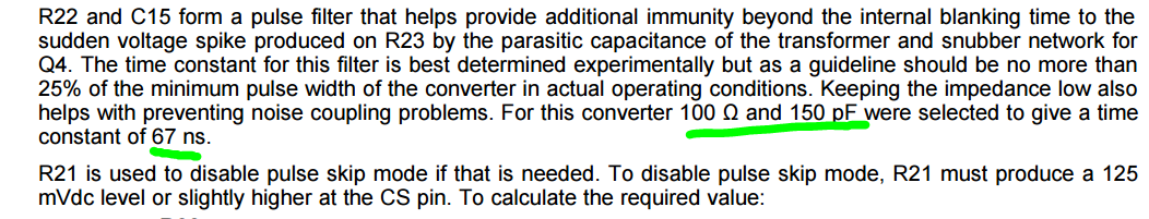

Looking at the datasheet for LM5021
www.ti.com/.../lm5021.pdf
How has 67nS been determined, I work it out as 15nS?
