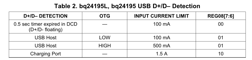

2. Detect the voltage on OTG.
Thus, there are following combinations:
     PORT             OTG                  I(limit)                 BOOST (determined by OTG and Register)
1. USB                LOW                 100ma               CAN'T be used
2. USB                HIGH                500ma               CAN be used
3. Adapter(>=5v)          LOW                 User's config     CAN'T be used

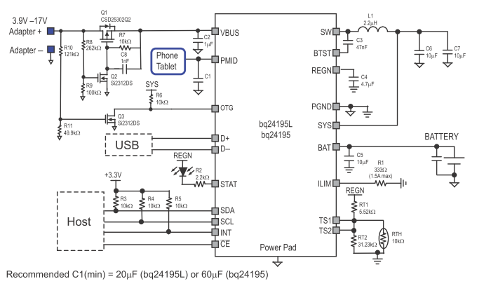

I can understand that, the OTG will be low when adapter is plugged in, because the voltage >= 5v, thus the Q3 in the schematic will must be opened.
Yet my question is, normally, the usb port is also 5V, thus, the Q3 will also be on, after USB Port is connected,  which means that's the case 1. Then the input current is limited to 100ma.
I mean how to use USB port to charge the battery, or a power bank?

    If VBUS is less than VBAT+VSleep (typ 80mV, max 120mV), OTG cannot be activated. In your example, if you have the adapter plugged in, that means that Q3 will be turned on and the OTG pin will be held low, disabling the OTG functionality. This way, you won't be trying to charge and discharge at the same time.
    For power bank applications, the boost output current is provided from the PMID pin. Please note that there is no boost current limit setting when the boost current is sourced from PMID pin, hence it is important not to overload the boost current under this condition.

  • Thank you very much for your reply. It helps me solve most of my problems. Yet, I still have a small question:
    From the table, when D+/- Detection is USB HOST and OTG = HIGH, the input current limit = 500mA. How this  case can be possible? I mean, when this chip is connected to USB Supply, normally 5v,  Q3 will be on, then the OTG = LOW. It seems it's impossible that the OTG is HIGH when we use USB port.
    Couple things to notice: the bq24195 is a device intended to be controlled via I2C; also the schematic presented on the datasheet is only one example of an aplication implementation.
    In this example, if we are trying to control the input current limit in a standalone configuration using the external Q3 FET, the USB host will be limited to 100mA. In this example, the charger is controlled by a host as well, which can modify the input current limit registers if desired, for example to 500mA.
