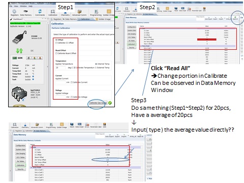

My customer intend to going to production with bq27520-g4 with bqStudio ( not bqEVSW) soon.
It is first time to use bqStudio for them.
They have gg .csv and golden files (.srec, .bqfs, dffs )  already  by bqStudio .
Those are kindly made by local FAE.
Now they want to make golden files ( df.fs file ) for  average of 20 samples ( 20 PCBs of their product)
I had read slua449f.pdf ( Going production with bq275xx ) , but I could not understand for bqStudio case.
Would you please kindly let me know?
Question1
My understanding is, if they had a gg .csv file and golden files already, they do not need to have
discharge/charge cycle test.
Is it correct?
Question2

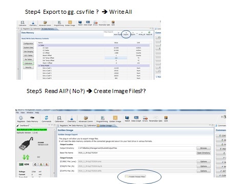

If Q1 were yes, would you please let me know the  proper  proedure for how to make  golden image files  which were
calibrated  /20pcs averaged with bqStudio?
I had attached the file  for  explanation about  steps( I am not confident with this ...I don't know it is correct or no ).
After the step3 of  attached, I don't know the way to make golden image files.

  • Hi Kanji:
    Question 1:
    If a learning cycle was done prior to extracting the golden file, then you do not need to do any charge or discharge cycles or tests. The learning cycle is necessary to learn the qmax and resistance table
    question 2:
    if you do not want to calibrate each board individually, that is when you need to calibrate 20 boards and take the average of the calibrated values.
    You simply need to average the calibration parameters in the calibration section of the gg file, input the averaged values in your golden gg file and that will now be your new golden file. Program the gg file on a device and then extract the flashstream file (bqfs or dffs). This file will have calibrated values and will be your new golden flash stream file.
