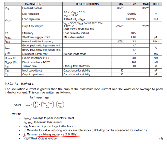

My customer has question about LP8731-Q1.
Could you tell me about questoin?
[Question]
- How much is the variation of switching frequency?
There are fosc(min)=1.7MHz and minimum switching frequency=1.6MHz in datasheet.

I think that 1.7MHz is the correct one and 1.6MHz is a typo but need to check with design to confirm. The electrical specs are with Vin=3.6V. Of course, if you use 1.6MHz for calculating the ripple, then you're on safe side on inductor selection.
