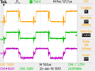

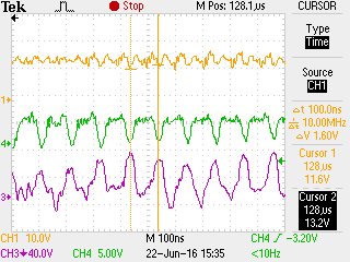

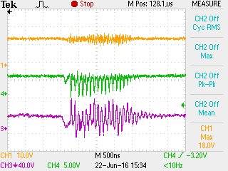

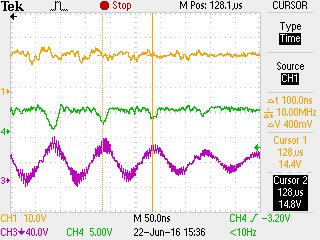

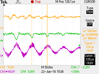

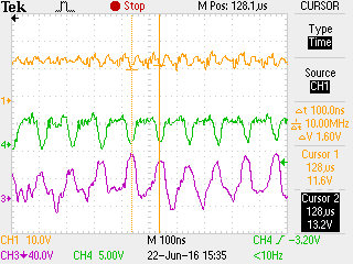

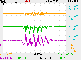

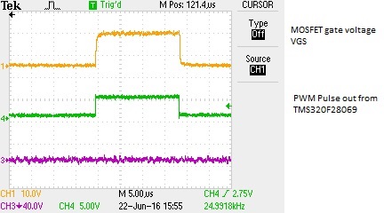

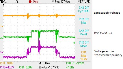

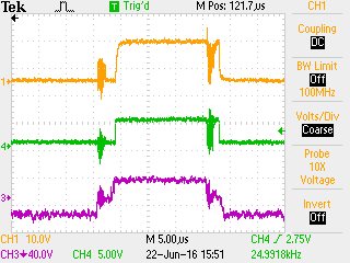

    Thanks for your immediate replies.Kindly look into the following waveforms with my present gate driver ADuM4223.
    The switching frequency is 25 kHz.The noise frequency is 10 MHz.
    It seems that the ground noise gets coupled back to the DSP PWMs as shown below.
    Topology : Phase shifted full bridge
    Can you assure that the issues what i am facing with my present isolated driver will be completely rectified using UCC21520?
    When Vdcin : 31V
    When Vdcin :32V ,Vdcout : 310 V
    When DC input is Zero
    Kindly write your suggestions/comments to solve the above issues.

  • Hello Ramesh,
    I saw the waveform, and Yes, it is quite noisy. Could you please help confirm the following points?
    1. The driver is an isolated driver, are you using differential probes to measure the primary and secondary signals? do you measure the signal with tiny pig-tail loops?
    2. We recommend the there should be no overlapping between the primary side and the secondary side for minimizing the noise coupling. could you please refere to the layout section of the UCC21520 datasheet for layout recommendations.
    Please let me know if you have further questions.
