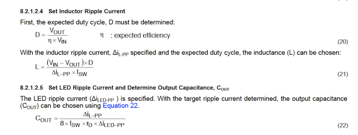

  • HI Kura-san,
    Adding C11 and C12 will help to reduce the LED ripple current. See this excerpt from page 23 in the datasheet:
    By the way, I believe you are correct in that DLP should be DNP. Note: The TPS92641 actually worked very well in DLP applications.
