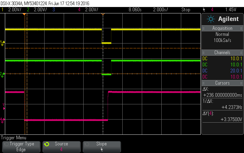

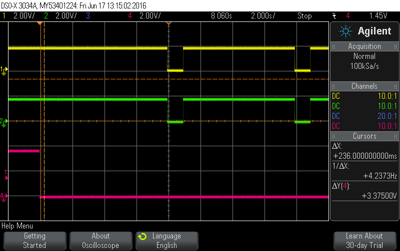

  • Hello Richard,

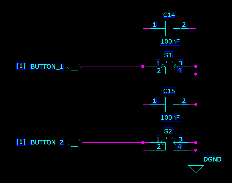

    Please see below the waveforms for the two different cases, with the UART connected (uart_on) and unconnected (uart_off). Something seems strange on PB_IN in the second case, however, the connection of PB_IN from J4-1 is as shown in the third image.
    Yellow: AC
    Green: PWR_EN
    Purple: PB_IN
    uart_on: UART attached, power off successful
    uart_off: UART not attached, powers up on its own ~8s after power off
    Nikos
  • Hi Nikos,
    I see that you also have an external pull-up to VDD_3V3A, while there is also an internal pull-up for PB_IN to an Always-On LDO. I'm wondering if something on the 3V3A rail is pulling down your PB_IN voltage, which might be somehow supplemented by UART0_TX when it is present. Does removing R83 change the behavior at all?
  • Hi Richard,
    Seems that you have put us on the right track: the button that is connected to PB_IN is also connected to a CPU GPIO (GPIO1_18). Removing R83 alone did not resolve the issue, the board starts to power-cycle indefinitely (obviously because of the GPIO); however, also cutting the GPIO link seems to have altered the behaviour of the system, and it now stays powered-off when connected to AC power. The issue however remains when connected to a battery: even without R83 and the GPIO connection, the board powers up again immediately after power-off.

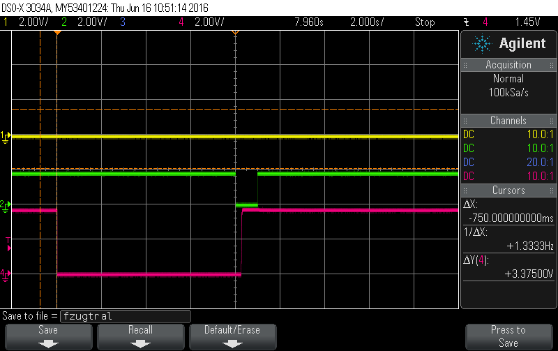

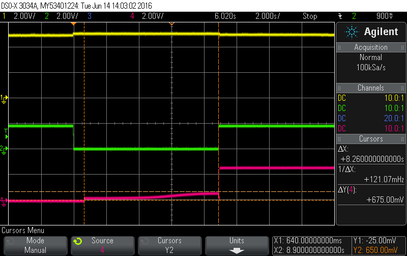

  • When BAT is the only supply, the PB_IN pin is the primary start event, so does this pin look any different operating from BAT vs. AC?
    Does the PMIC behave the same for both software and hardware shutdown events?
  • It does not look that the PB_IN pin behaves differently between BAT and AC operation. Please see below two captures, one with AC and the other with BAT. In BAT operation, it seems that PWR_EN rises without any transition on PB_IN (the button is left right after the power-up was noticed).
    The behavior is the same for both software and hardware shutdown events.
    Yellow: AC
    Green: PWR_EN
    Purple: PB_IN
    AC powered: PWER_EN falls and remains low
    BAT Power: PWR_EN falls and then rises again

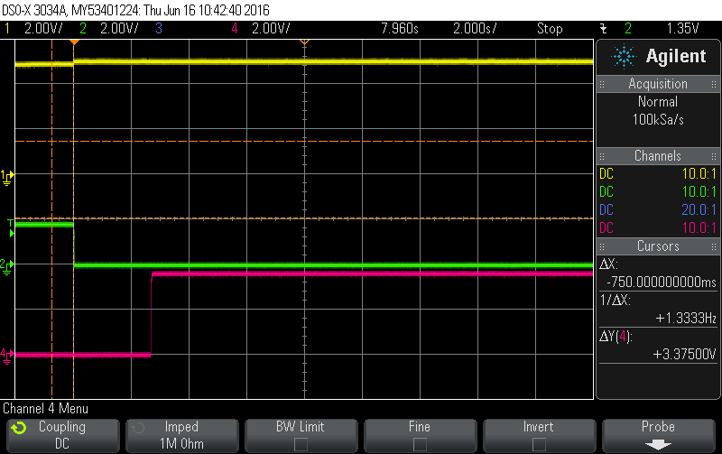

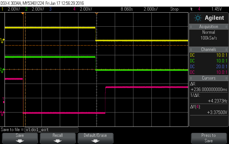

  • Hello Richard,
    It seems I was mistaken in my previous mail, the software shutdown even was successful, the hardware event fails.
    Please find below the capture of the hardware event, in the AC and BAT power cases. For battery power, there are two graphs: one with the PB_IN button lifted as soon as PWR_EN goes down, the other with the button kept pressed, showing a repetition of powerup-poweroff cycles.
    Yellow: VLDO1
    Green: PWR_EN
    Purple: PB_IN
    AC power
    BAT, with PB_IN pressed until initial PWR_EN low
    BAT, with PB_IN pressed constantly
  • Hi Nikos,
    This means that something is asserting PWR_EN. The Sys rail will behave differently when BAT is present, so possibly investigate that rail for possible paths back to this pin?
