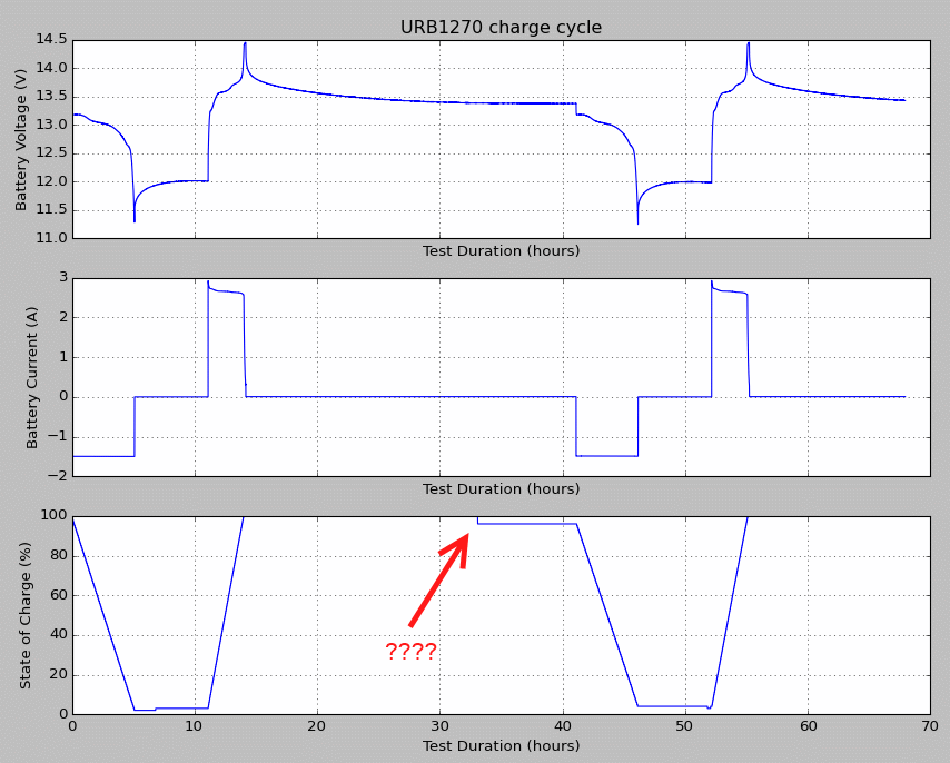

Getting some pretty good results with my system so far with the bq34z100-g1 and a 4S LiFePo4 pack - I have one last problem.
After charging, when the pack goes into relax, when the bq34z100-g1 measures OCV, the SOC drops by a few percent, from 100% to 98%-95%, differs each time.
Is there a setting that can stop this or is it actually indicating that the battery is not fully charged?
See below plot, there are several charges and several discharges.
Bryce

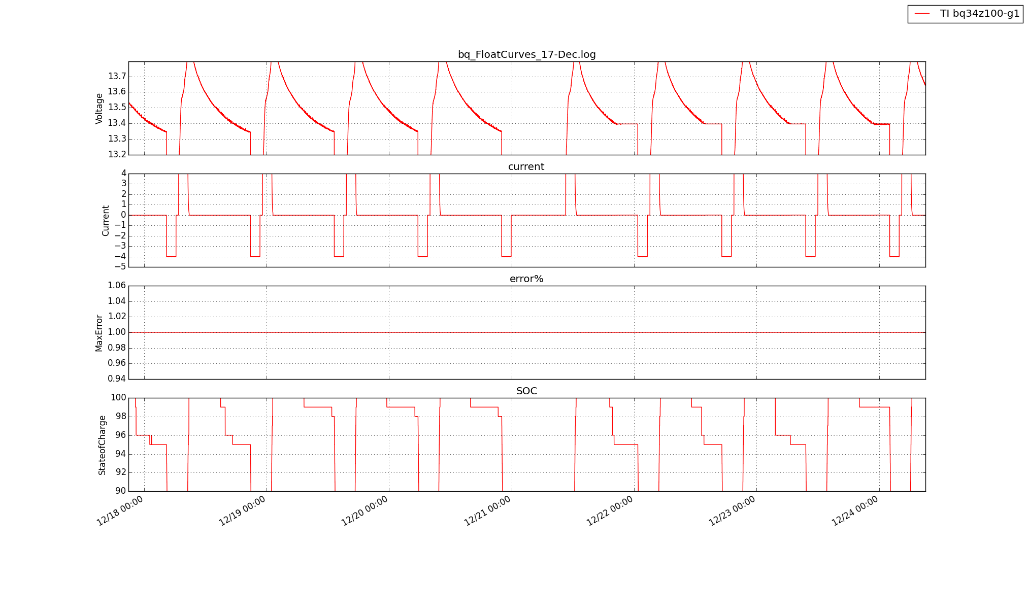

    We have found that within 24 hours the pack relaxes and the SOC goes down to 95%, this is when our maintenance recharge threshold is set for and so it is causing excessive charge cycles on the battery.

    I'm not sure what is causing the issue, but it looks like the OCV bit is getting set too soon? It is set after ~2 hours battery relaxation, but the battery appears to take around 15-20 hours to fully relax.

    I reviewed your log file. The gauge checks for cell voltage stabilization over consecutive 100s windows and the voltage stabilized enough to set a DOD point at that point. The Qmax DOD point continues to update throughout the rest period as the voltage continues to drop, so this should not cause a problem with your gauging.

  • Bryce
    The RM and and SOC adjustments were due to a capacity simulation and the downgrade was correct based on the voltage. You could set the RELAX_JUMP_OK bit to 0 and this should keep these values from changing until the start of discharge, but they will drop at the start of discharge. You could try using the GPCCHEM tool to see whether you can find a better ChemID match that will have a lower top OCV threshold. ChemID 401 has one of the highest top OCV thresholds for all of our LiFePO4 ChemID's. You could also try reducing the taper current to allow the cells to charge fuller and perhaps not drop as much during rest.
    The Qmax DOD is used in Qmax updates. It get adjusted during rest as the cells change.
    Tom

  • Bryce
    I checked the srec file and found it to contain ChemID 437. The top OCV threshold is higher than the rested OCV for your cells, so a drop is expected during rest. I suppose that I was referring to the CV termination current, although this is usually just below the taper current.

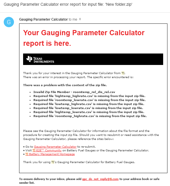

  • Ok i must not be defining the log file correctly, i get the following response after submitting my zip.
    I'm following "www.ti.com/.../slva725.pdf" as a guide as linked from the GPCHEM website.
    2 - Required Data The GPC tool requires a single .zip file containing one configuration file, one data file, as input. The name of the .zip file is not important. The .zip file should contain the following files: • config.txt • roomtemp_rel_dis_rel.csv
    Typical settings are: ProcessingType=2 NumCellSeries=1 ElapsedTimeColumn=0 VoltageColumn=1 CurrentColumn=2 TemperatureColumn=3
    Excuse the crude copying from the .pdf.
    Please let me know the correct settings for the config file.
    I have a 4S5P battery and a few datafiles logged with bqStudio.
    Bryce
  • It looks like you submitted the file to GPCCEDV instead of GPCCHEM. Here is a sample config file for GPCCHEM.

  • Hi Tom,
    I've just stepped through the process again.
    I'm using the tool at the link; http://www.ti.com/tool/GPCCHEM.
    Everything seems to point to me using GPCHEM.
    Attached is the zip file i'm submitting. Please let me know what i'm doing wrong.
    URB1270.zip
    Bryce
  • Bryce
    I cleaned up the files and it should pass if you submit these files.
    Tom
    5773.input_data.zip
