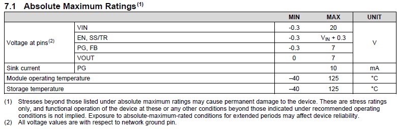

    2. Another question, Datasheet Page 4 lists "Absolute Maximum Ratings". For VOUT, it's 0 to 7V, does this mean that even when VIN = 0V, VOUT can stand an external voltage (up to 7V)?

    2. If a voltage is applied to the output without an input voltage, the output voltage will appear on the input due to the body diode of the high side FET. This is true of almost any buck converter. If there are other circuits on the input, they will be powered. If the input is shorted, this will consume current. The Tj of the device is the limit to remain within in these cases. But again, this is fairly atypical in most applications to have this condition. So, I would really like to understand more about what you are trying to do.
