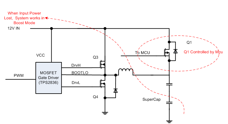

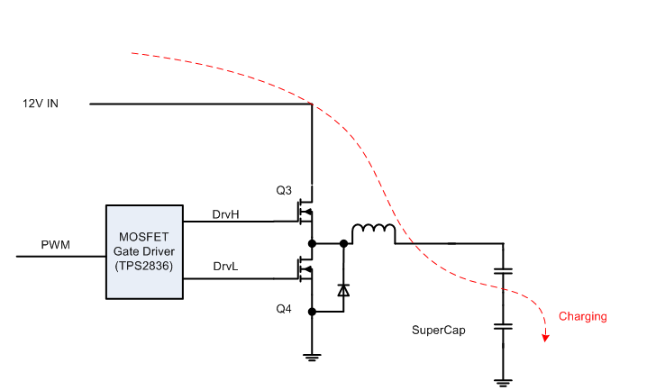

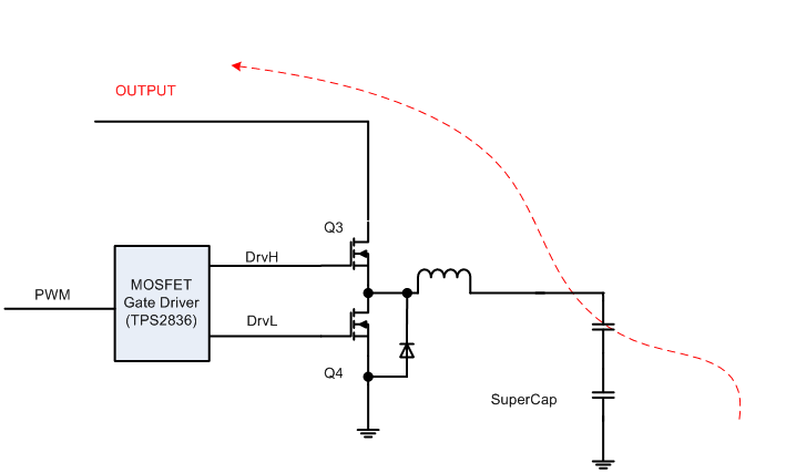

I'm looking at using the TPS2836 to charge a super cap and was wondering if it is possible to use the TPS2836 in the same configuration to regulate the discharge of the SuperCap.
Below are high level diagrams on the charge and discharge configurations.

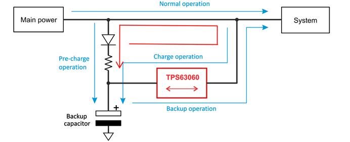

    Thanks for the suggestion. The majority of the supercap designs and documentation suggest using a buck-boost to regulate the charge/discharge of the supercap.
    However, in this application the system can accept 4V-13.5V, therefore there is no need to closely regulate the discharge of the supercap and the addition of a buck-boost would just cost power. Have you seen any applications where the discharge of the supercap is unregulated or do you know of a configuration that this would be possible?

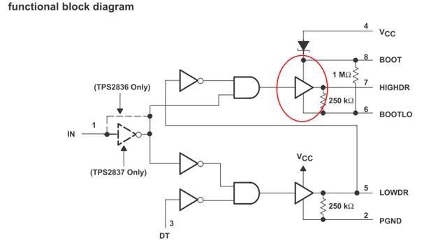

    The issue that I'm seeing with the original configuration is that during the discharge the VCC voltage of the TPS2836 is lower than the BOOTLO pin, therefore the HIGHDR signal won't be able to turn the high side FET on. Are you aware of a different Gate Driver that TI offers that can mitigate this issue or have another suggestion?
