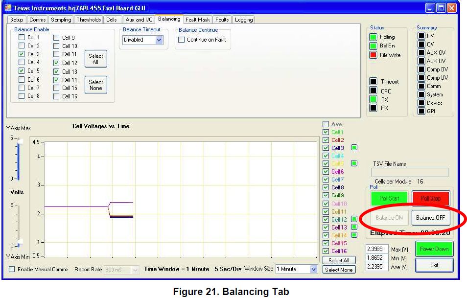

My customer is evaluating BQ76PL455EVM and can control cell balance FET by balance ON/OFF bottom of GUI. They hope to know the actual command when use balance ON/OFF bottom.
Can you kindly explain it?

Hello Sonoki-san,
Clicking on the "Balance ON" button sends a write to the CBENBL register (address 0x14) with the value configured in the upper left of the GUI (in your case, 0x3814), followed by a read of the CBENBL register for the GUI to verify the write occurred.
Clicking on the "Balance OFF" button sends a write to the CBENBL register (address 0x14) with the value of 0x0000.
