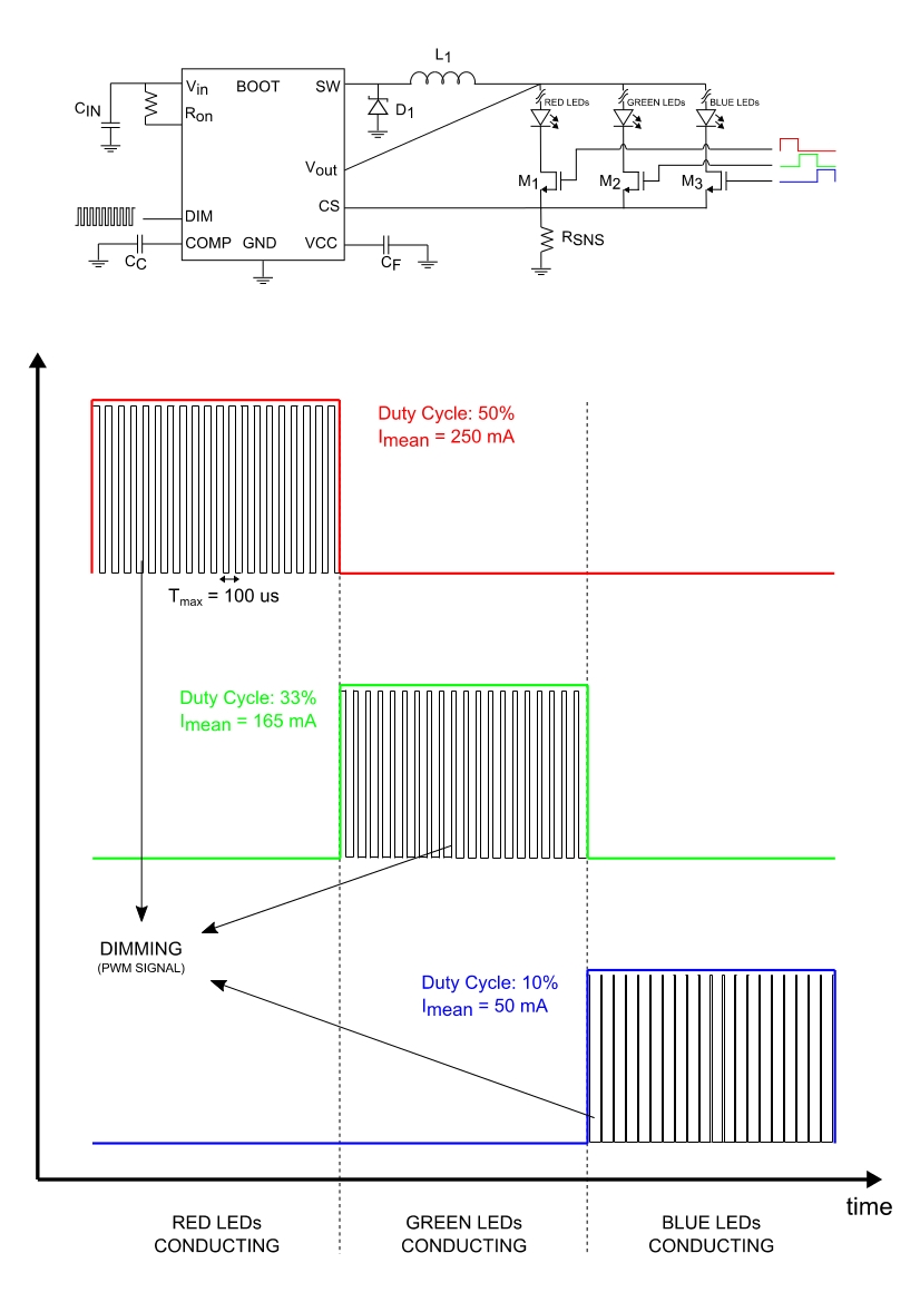

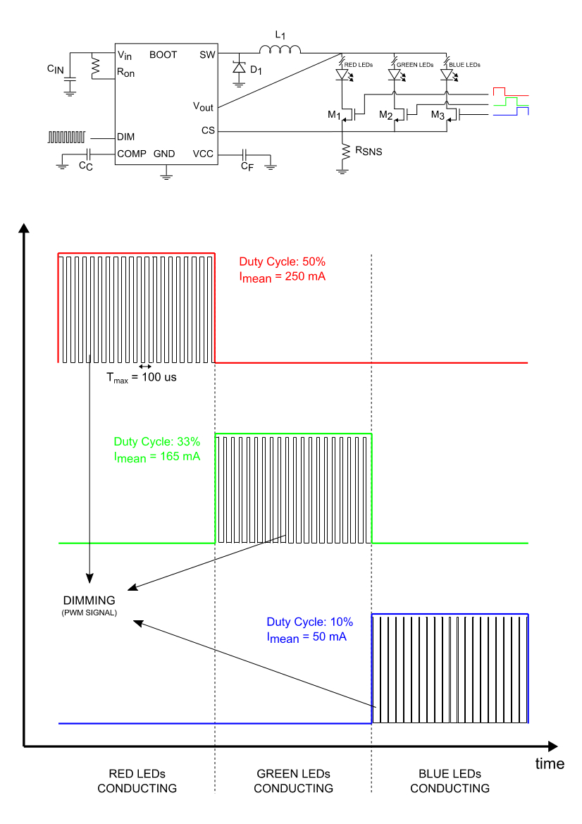

Good afternoon,
is it possible to use the LM3406HV as depicted in the figure below or it may damage the inductor?
The purpose is to feed each LEDs string for one third of the overall period, therefore the current circulating inside the load  may undergo some little ripple.
- PEAK CURRENT: 1.5 A
- DIMMING FREQUENCY: 10 kHz (or higher)
- DIMMING DUTY CYCLE: <= 50% and varies in phase with gates transitions
- LOGIC FREQUENCY: 100 Hz
- LOGIC DUTY CYCLE: 33.3%
