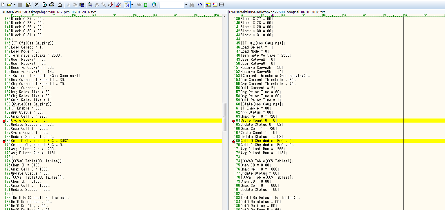

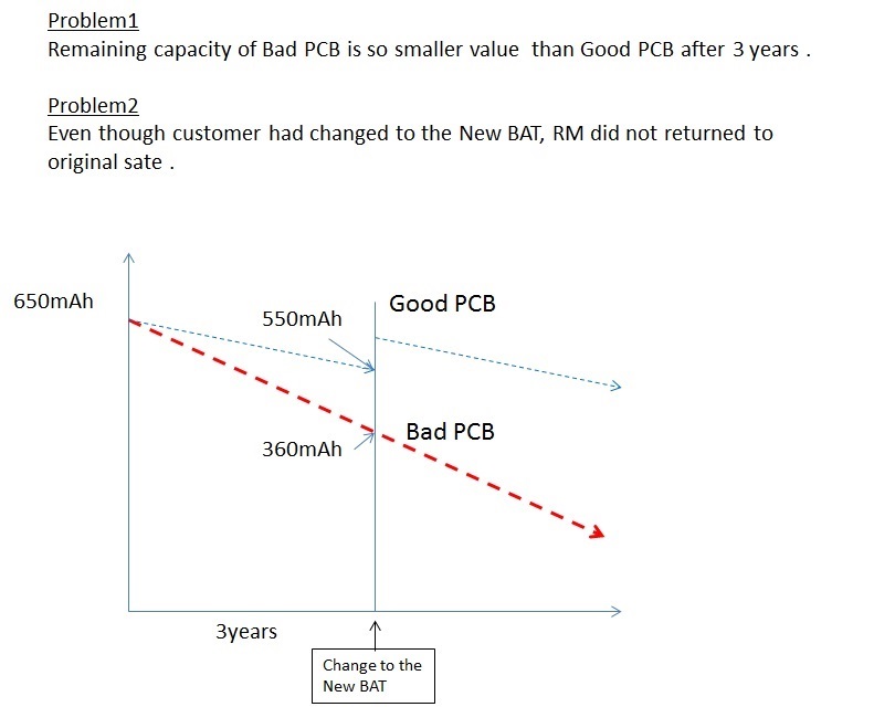

My customer is suffering  return from market that their product using bq27500.
Bad PCB indicates  RM= around 50~60% even though they had insert  new battery.
Return is approx 10  from 6,000 total.
Please refer to attached.
I had read gg file from their  returned 'bad' pcb and  good(original)  pcb using i2c. ( attached )
From those  , cycle count  and Cell 0 Chg DOD at EoC  is  different.
#Bad  pcb
Cycle Count 0 = 8
Update Status 0 = 02
Qmax Cell 1 = 720
Cycle Count 1 = 0
Update Status 1 = 02
Cell 0 Chg dod at EoC = 6462
#Good pcb
Cycle Count 0 = 0
Qmax Cell 1 = 720
Cycle Count 1 = 0
Cell 0 Chg dod at EoC = 0
Question1
Would you please advice/ estimate  why the Bad PCB of RM is so small?
Do you think Cycle count = 8 is  something problem? ( i.e. its seemes  application issue ?)
Question2
Customer says  the  issue: RM, is small value  ; does not  fixed even though they had changed to new battery, and
discharge( C/25 ), charge ( C/3).
Would you please adivse/estimate  why bad PCB does not fix the issue?
Question 3
Please adivse what to do next for investigation.
Sorry to bother you, but please advise

  • hi kanji,
    Which gg file is from the good unit and which is from the bad unit. Why does the good unit have cycle count =0. Was this unit never used?
    It appears the problem with the bad unit was that DOD@EOC updated to a large value. You will need to run a few cycles on a good unit while logging with bqEVSW to see if you can reproduce the issue. pls provide srecs from the good and the bad units as well.
    thanks
    Onyx
    Dear Onix san
    Thank you for your comment !
    According to customer, return from market ( 15pcs )   has big DOD at EOC value;  ~ 7000 .
    I can not understand the reason why this occurs, because customer's gg file setting is IT enable = 00 ( desable), so, Qmax and Ra table
    should not be updated .
    OK, I will make a test( a few cycles ) using bqEVSW, but,   would you please give me your comment the reason why DOD at EOC is big?
    With My Best Regards
