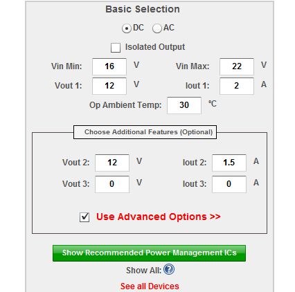

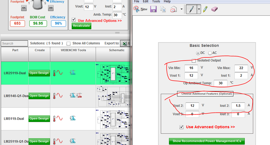

I'm working on a design that requires a pair of clock synchronized supplies, each delivering nominally 12V at 2.5A, but with each voltage independently adjustable from about 11 to 13V.
Webench indicates that the LM25117 is suitable, so I'm wondering if I could simply use the LM25117 calculated values with an LM25119 to save a little space and cost?
