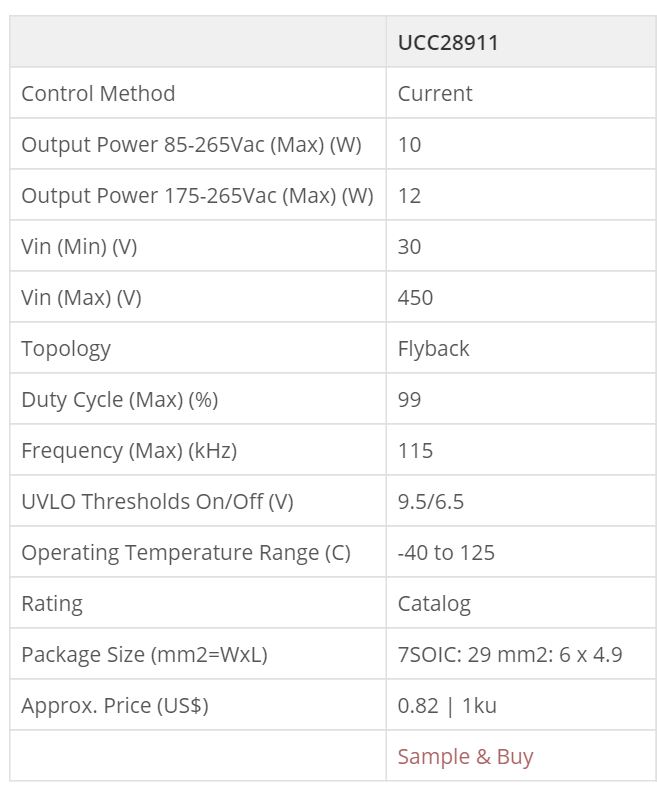

  • For low input voltage 60-90 V, the UCC28910/1 would not be suitable - they are not guaranteed to start below 100 V, and the internal FET Rdson would be too high - they are intended for offline AC-DC applications.

  • Thanks for reply and advices,
    I saw this table in your site (Link: http://www.ti.com/product/UCC28911?keyMatch=ucc28911&tisearch=Search-EN-Everything),
    and then I decided to make our project with UCC28911. After that, ı ordered even last day.
    Can you give an advise for Li - ion battery charger and  constant voltage flyback converter ?
