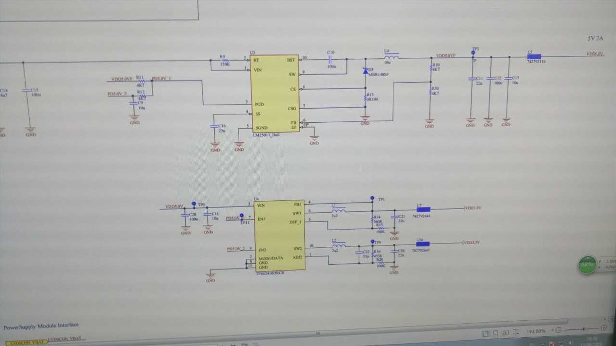

the schematic and component selected value, please see the shecmatic screenshot below

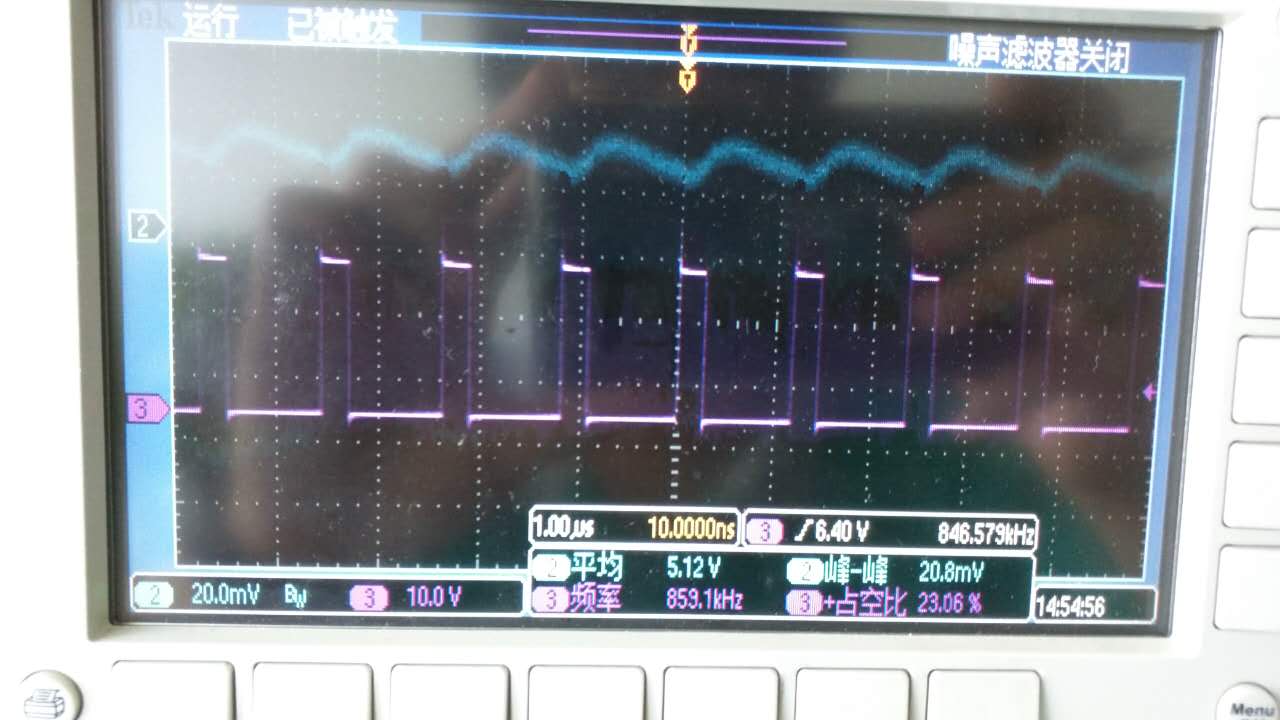

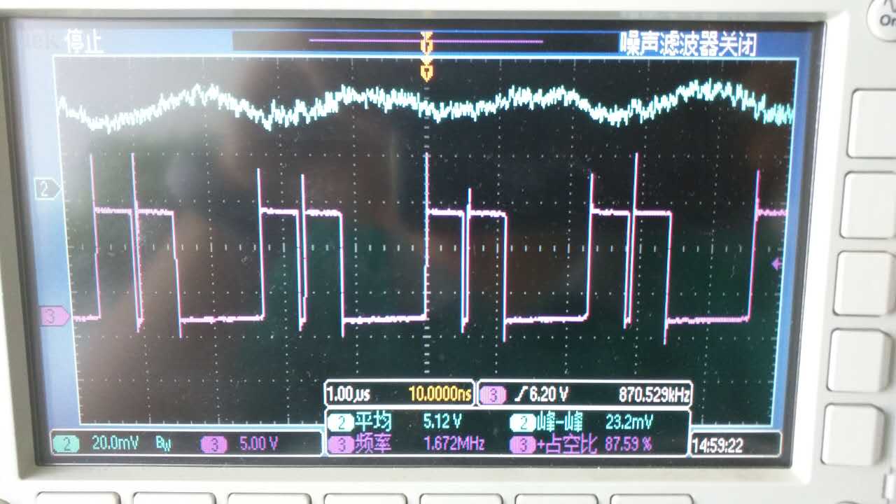

when 12V input, I probe the phase node, there is some unstable waveform, the chip is not the continouse PWM mode, but looks like not uncontinous mode too, it looks like some unstable waveform on the phase, I have no FRA equipement to check the compensation. when I increase the input voltage to 15.4V and bigger, the phase node is in the continouse PWM mode, should work normally.
Please see the phase node waveform of 12V input
please see the phase node waveform of 15.34V input
