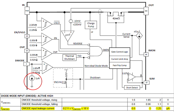

Hi Team,
We would like to know the constant current source.
I understand that this spec is “DMODE input leakage current”.
Is my understanding correct?
If no, could you please let us know the maximum value of this current including variability of " temperature " and " process "?
Kanemaru
