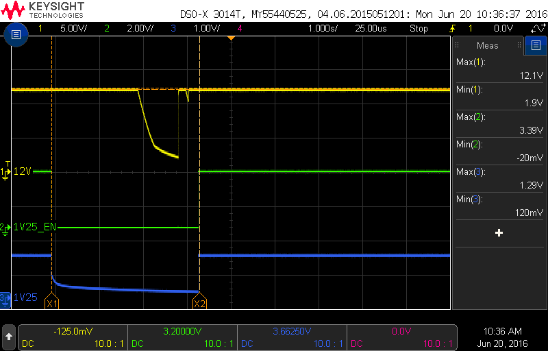

My customer found TPS54326 output discharge function is failed.
Please refer to below scopeshot.
Input is 12V, output 1.25V
While we pull down the enable signal, 1.25V output is drop.
But after 3 seconds, we still see the output is with 200mV.
It looks like the discharge function is failed.

  • The output discharge FET is only 50 ohm. Only 4 mA current is required to get a residual output voltage of 200mV. You may need to allow more time for complete discharge. If there is any leakage path to another voltage rail on the output, there may be enough current available to maintain some amount of voltage indefinitely.

    The discharge resistance is 50ohm, it should be easily to fully discharge the 200mV even 1.25V in 3 seconds.
    The time RC time constant is 5m second, 3 seconds is 600 times already.
    I will check if any leakage path.

    After checking with customer's board, we do believe that TPS54326 is with some problem for the output discharge.
    You said that the output discharge resistance is about 50ohm, but still cannot fully discharge the 1.25V output which is with <100uF capacitance in 3 seconds. My customer can fully discharge the 1.25V output in 200ms by adding only 200ohm resistor.
    Could you please also check this at EVM?
    The case is quite urgent, could you please check with designer to see if TPS54326 can really fully discharge the output voltage or not?
    Or is there something we missed to make the output discharge function work well?

    we have tested in lab, the discharge time is about 20ms in our EVM, will send you email for detial deacription,
