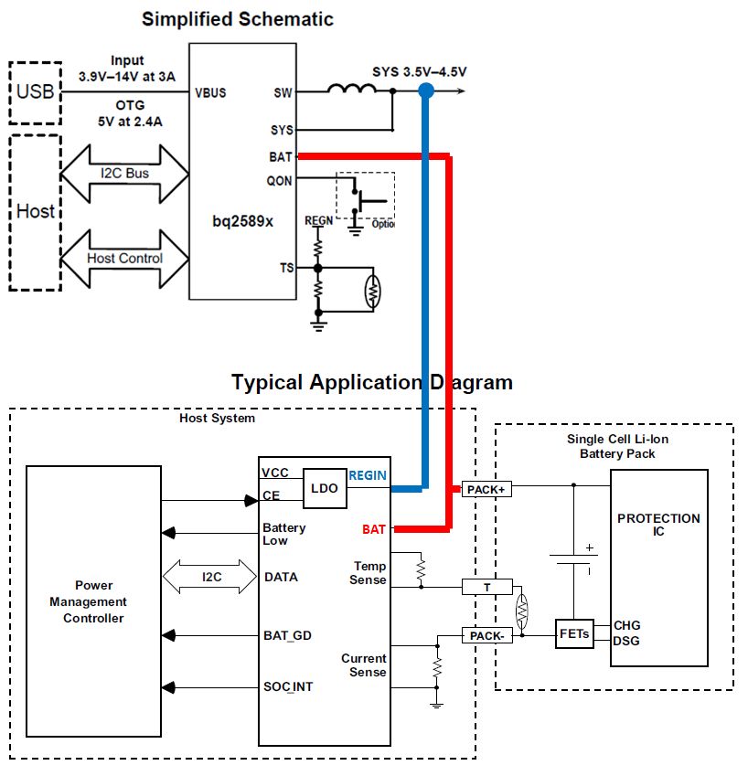

My customer plan to connect REGIN to VSYS of charger IC (bq2589x) as attached. The purpose of this configration is to reduce load from battery at ship mode of bq2589x because bq2589x can disable VSYS at ship mode. Then please give your comment for following question.
  1. Can you recommend this configuration? Please let me know if you can find undesirable situation.
  2. Is there no issue to apply battery voltage to only BAT pin at bq2589x ship mode?

  • Hi Onyx,
    Yes, the charger and gauge will be in system side, so the charger will be attached to gauge. But VSYS will be turn off at charger IC in shipmode though battery voltage is enough high. I think usually REGIN pin is connected to BAT pin and powered from battery directly. So I'd like to confirm if this attached configuration can be recommended.
    Best Rergards,
    Sonoki
  • Regin is just a power supply input to the LDO that powers the chip so i do not see anything wrong doing the connection that way.
    thanks
    Onyx

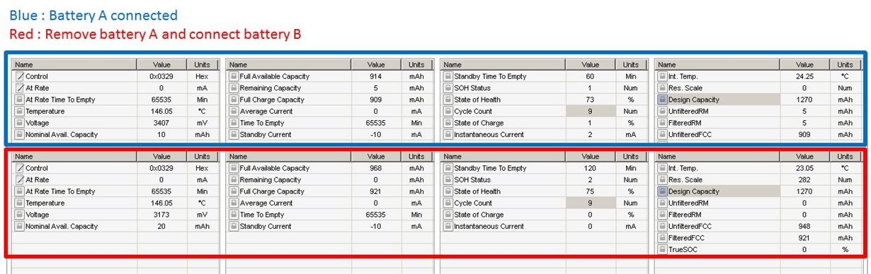

  • Hi Onyx,
    I tried to connect different battery and check the value in resister window. Then Cycle Count shows the same value, it looks the value is not reset. And also Design Capacity shows the same value, it looks the value is not reset. I assumed that these value are reset and change to default value.
    Sonoki
  • Hi Sonoki,
    Those don't get reset to default becuase they are contained in data flash. When the gauge is powered on, it initializes and updates the RAM parameters contained in data flash from the data flash.
    thanks
