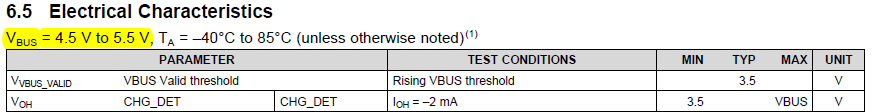

Hi Team,
According to the recommended operating range of VBUS is 4.75V to 5.25V.
Our customer can’t adjust VBUS to this range because this cause is wiring loss.
Then, VBUS is 4.6V to 5.4V.
However, the electrical characteristic is prescribed in VBUS is 4.5V to 5.5V.
So, I understand that their value(VBUS is 4.6V to 5.4V) does not have any problem.
Is my understanding correct?
