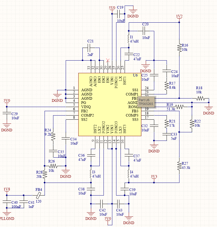

I've made a design using the TPS65266. It takes a 5V input and steps it down to 3.3V, 1.8V and 1.2V to power an AM1705.
However when I supply the 5V I see 0.9mV voltage on the ouput rails for all three outputs. I measured the voltage on the enable pins and it hold steady at ~50mV while the SS pins ramp up to 100mV then discharge back to 0V.
Any help will be greatly appreciated.
My schematic is shown below:
