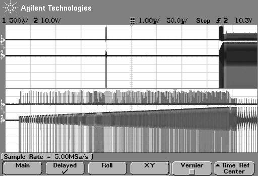

Below, a proper startup-sequence is documented. It was captured while the capacitor on the CS pin was fairly high (1 nF, reference: e2e.ti.com/.../522410).
BTW: a fairly high overshoot in the VDD voltage (top trace, approx. 35V) occurs here. The bottom trace shows a 16V secondary voltage (bulk cap: 220 uF, operating voltage 16V).

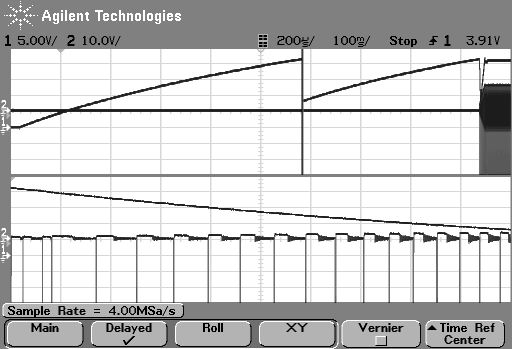

Next capture is without 1 nF on the CS pin (and Vdd capacitor 330 nF) Startup time would be 600 ms without the failed charge in the middle:
After the first Vdd-chargeup, Vdd goes back to undervoltage lockout. The second "try" goes OK. In this case, not the secondary rectified voltage is captured, but instead the voltage on the secondary winding. It can be seen that the switching frequency start quite low, and increases with increasing secondary voltage??

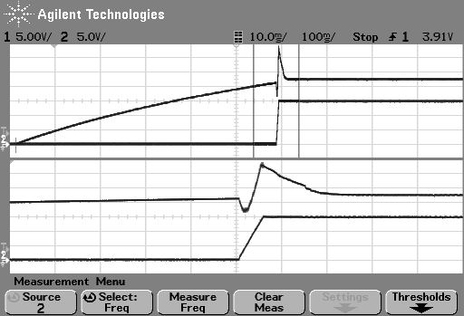

Next, more detail is given. Here, not Vdd is shown, but the voltage on the CS pin (with 100 pF). In the middle, a first PWM start did not transfer enough energy before Vdd touches undervoltage lockout.
The top trace shows that the CS ramps up to approx. 750 mV (with some variation mainly due to 5MSPS sample rate - zooming has proven that what you see here is truly the top of each current ramp, not any spike). This is Okay. It can clearly be seen that the frequency starts low and then increases. Why is the frequency not at least 44 kHz right from the start? The output capacitor would charge much faster!

    - Looking at the first plot above, one can see that there is a significant overshoot in VDD as Vout ramps up, yet Vout does not overshoot. This tells us that the primary peak current is large (due to the 1-nF CS pin cap), and also the aux winding leakage inductance is probably large. If the CS pin RC filter is excessive, this will result in higher actual peak current vs the programmed peak current at the CS pin. This will then force the control loop to run at lower freq, since the energy per cycle is higher than it ought to be. The higher peak current will also lead to more energy stored in the leakage inductance, which in turn will cause the Vdd rail to pump up to a higher level - as can be seen in this case. Very often, a small-value resistor is used in series with the aux winding diode (1-10 ohm) to limit the over-charging effect on Vdd due to the aux leakage inductance. Not too, that the RC filter on CS will have a more pronounced effect as input voltage rises - since the di/dt of the current is steeper at higher voltage, the RC delay results in more overshoot.
    - For the second plot, with the smaller filter cap on the CS pin, it looks like the Vdd rail falls too low while Vout is ramping up - there is just not sufficient energy storage in the Vdd cap. The next plot also confirms this. With smaller CS filter cap, peak current is lower (closer to what it ought to be), so the output cap ramp rate is slower, so the Vdd needs to sustain the IC bias power for longer. Moreover, the lower Ipeak means there is less parasitic energy storage in the aux leakage inductance, so again the Vdd rail replenishment from the aux winding takes longer.

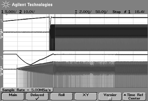

    The third plot indeed confirms that the startup is not OK yet. Here, below you'll find a trace capture where the output capacitor is 100uF:
    Note: the irregularities in the middle part reflects irregular current consumption due to MCU activity.
    Vdd drops to approx. 10 V. Regarding equation 13 (thanks for attending on this), 100 uF seems a fairly good choice because that equation supposes a voltage drop till 9 V.
