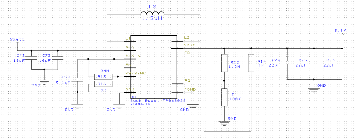

I made my own board with TPS63020.
I am using a 3,7V battery to supply the board.
The TPS63020 keeps output voltage to 3,8V in order to supply another module and a microcontroller
When my module and my microcontroller enter in Low Power Mode, TPS63020 load is only a few µA. I pulled PS/SYNCH pin to GND to be in power save mode enabled.
Nevertheless, my board consumes 8 mA instead of being below 1 mA (which is too much with a small battery).
It seems that TPS63020 consumes a lot, is it possible ? What would I have missed ?
You can see schematic for TPS63020 on my board ...
I hope you can help me ...
Alexis
  • You should measure the actual output current and input current and actual output voltage and input voltage per this app note: www.ti.com/.../slva236.pdf
    You should also look at Vin and Vout with a scope to make sure they are steady.
    Finally, you can compare to the EVM to see if/how your circuit differs in performance. This points to a layout or BOM difference as the culprit.
