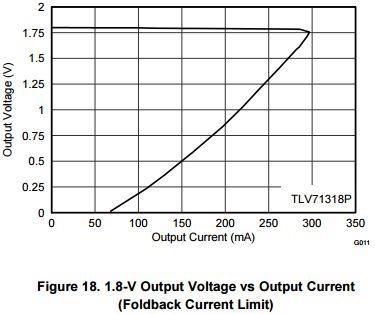

Please let me ask about behavior at current limit condition because there is no detailed description or waveform in datasheet.
Does TSP211x keep to flow ILIM continuously (constant current operation) or turn off internal power SW and try to turn on automatically (Hiccup mode)?
