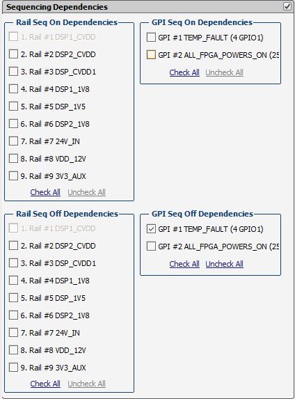

I'm using combination UCD9090, UCD9222 &  two UCD74111 to power two DSPs. I have external temp sensors glued to DSP heat sinks to monitor DSP temperatures. I want to turn all power rails off, when temp fault occurs.
I connected TEMP_FAULT signal (active low) to UCD9090 GPI1 (pin 4). I configured the GPIO1 pin as "GPI Fault Enable".
I can read the state of the pin correctly with GPIO pins peek/poke command. Also when I enabled fault log for GPI1 pin the fault was logged.
I thought selecting GPI1 on "GPI Seq Off Dependencies" (see picture) might work but it doesn't.
Any idea how I can turn the rails off with this GPI1 input?

  • The sequence-off dependency cannot initiate a shut down sequence. The dependency is only examined after a sequence is initialized.
    GPI input cannot trigger a fault shutdown.
    You have two options:
    (1) connect analog temp signal to a MON pin, and use it as a temp monitor.
    (2) connect digital OT signal to a MON pin, and use it as a temp monitor.
    In fault response, you can configure OT fault response to be shutdown.

    I connected digital over temp signal to MON10 input, adjusted under voltage limit to 300mV, set MON10 under voltage fault response to "shut down immediately" and set tab on fault shutdown slaves on all other rails. Now all DSP power supplies turn off when over temp situation arises. Very good.
