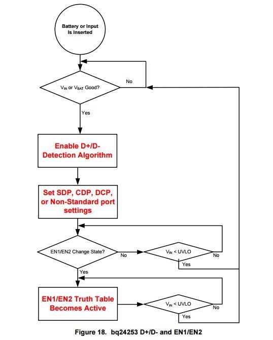

3. Which is Input Current Limit when connecting to a DCP port in EN1=0, EN1=0, 0.5A or External ILIM?

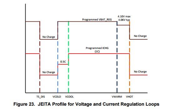

    2. as shown in section 9.3.10 of the datasheet, a JEITA algorithm is implemented in the device.
    According to Fig. 23, the battery FET is turned off only when on JEITA profile "No Charge" is indicated
    3. The question can be easily answered looking at Fig.18 in the datasheet.
    As soon as a DCP port is inserted, the current limit is set by the ILIM pin. In case the EN1/EN2 configuration changes, the current limit is set according to the EN1/EN2 truth table

    2. I'd like to know there is no input voltage, and whether temperature abnormal measure and a protection integrated circuit also function during discharge.
    3. Does a charge start after measure of a EN terminal?
  • Hi Hirotsugu,
    2. the device has no thermal protection in the conditions you listed
    3. The charge starts right after the input detection. EN1/EN2 detection occurs only after D+/D- detection and if the EN1/EN2 configuration changes
