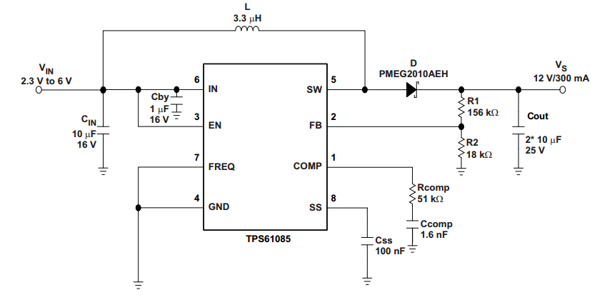

I'm using the TPS61085 to convert 5V to 12V to run some 3-pin fans. I'm controlling fan speed using PWM and N-mosfet. However this messes up the tacho signal, so I'm thinking of using a variable voltage supply to the fan to control its speed.
Can I use a digital potentiometer on the feedback resistors to vary output voltage between 6V to 12V? Will this have any effect on the compensation network?
I've used the reference schematic from the TPS61085 datasheet. I have used the following values in compensation network
Rcomp = 59k
Ccomp = 1nF
L= 4.7uH
I was thinking of replacing R2 with a digital potentiometer to obtain output voltages between 6 and 12V. How easy is this to achieve and are there any other issues that might crop up?

    Yes, you can use a digital potentiometer to realize the function. If you want to let :Rcomp = 59k Ccomp = 1nF L= 4.7uH, please make sure the "effective" ourput capacitance is higher than 10uF (so at least use 2*10uF considering the DC bias), higher output capacitance helps on the stability.
    If you can , you can also realize this function by amplifiers, you can check the PMP9774 for the detailed information. But this document use another IC, so you  just check the implementation idea.

    For this application, I am thinking of using TPL0401A-10DCKR.
    I am keeping R1 at a constant 66.5k
    For R2 - I have split that into two parts. One part = constant resistor, 7.5k. Second part = variable resistor, between 0ohm and 10kohm.
    When I change the value of the second part of R2, I can vary output voltage between 12.2V (at 0ohm) to 5.9V (at 10k)
    Could you please confirm if these values are ok for the application?
  • You can change the resistor while the switching is taking place!
  • These values are OK for the application!
