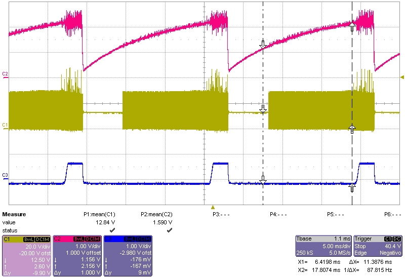

I'm in trouble with LM5116 during short condition : when I apply a shortcircuit in the output, the LM5116, and the mos low side they break both.
These are my features :
Vin=30Vdc
Vout=12V
Lout=22uH
Cout = 3x220uF
Fsw=200kHz
Rcs=10mohm
The input power supply is limited to 4Amax and the low side and high side mosfets are about 50A.
Does someone have some ideas about this ?
