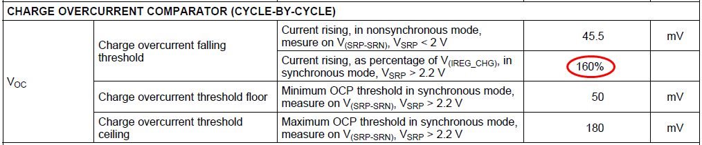

Please let me ask about maximum value of Charge overcurrent falling threshold.
I understand that there is only typical value in electrical characteristics that means you don't measure Charge overcurrent falling threshold at final test. And also I understand that you can't guarantee the maximum value, but then I'd like to know the design spec. The rough value will be OK like max value will be 150% of typical value.
