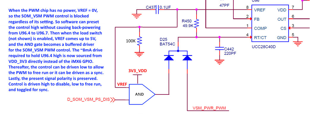

This question is a follow up to my previous thread from a couple of days ago. We have a new need to immediately inhibit the UCC28C40 when its VCC supply is first applied. The least intrusive design change was to add an AND gate as shown in the following graphic:

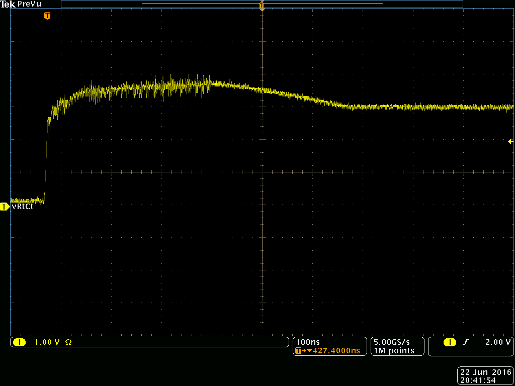

I've tested this and have two concerns. The following scope trace shows where VREF reaches the VIH of the AND gate causing the out drive to the RT/CT pin to go high:
  • VREF is only ~1.7V at this point, so technically we are still back-driving the RT/CT pin for another 10us or so. Is this OK?
  • I don't know what's causing the leading edge spike. The AND gate is 3.3V output drive and the spike is too long in time duration to be overshoot due to overdrive or common-mode. The voltage is within the maximum specifications for the pin but I'm sure they apply for when VREF = 5V.

I'm adding a second trace of just the vRtCt transition. This characteristic was captured with a TDP1500 differential probe.
  • Chris

    If you're worried about what you're doing to the RT/CT pin I recommend looking at OUT to make sure it doesn't cause any undesired behavior. If it looks ok there then you should be good. I've asked our experts for this part to review what you've done to make sure it doesn't cause any issues.
