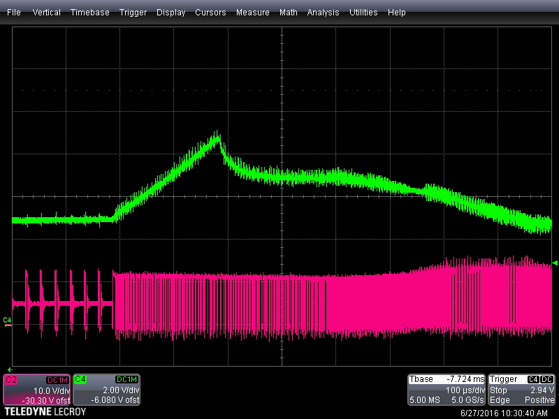

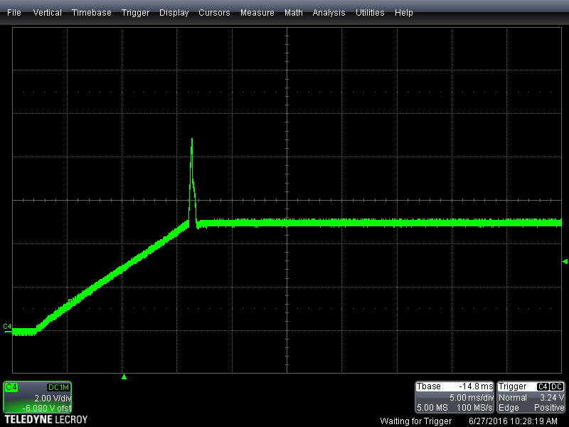

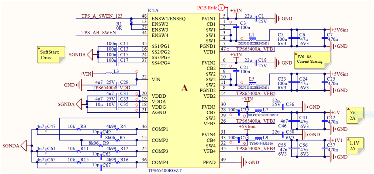

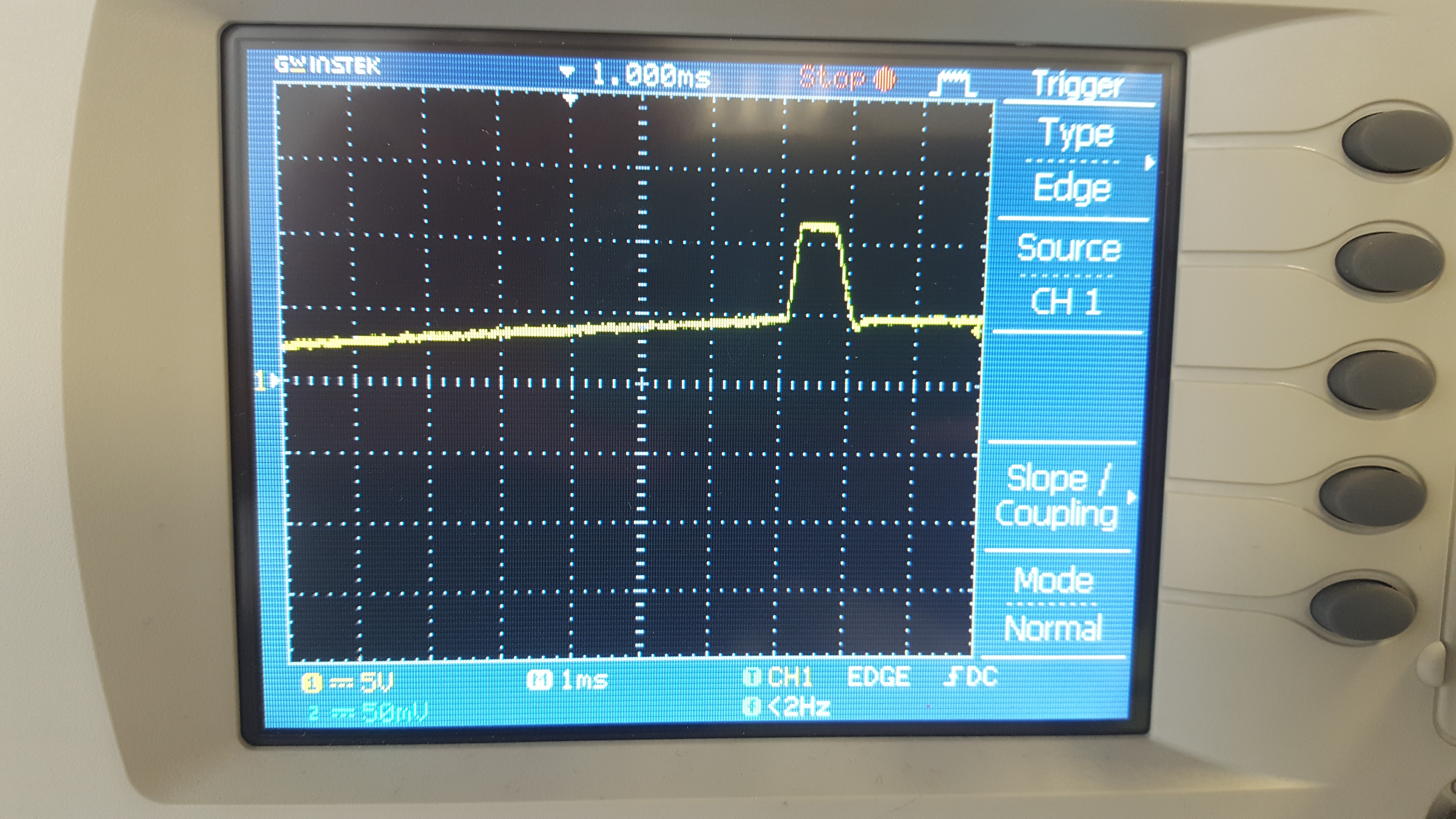

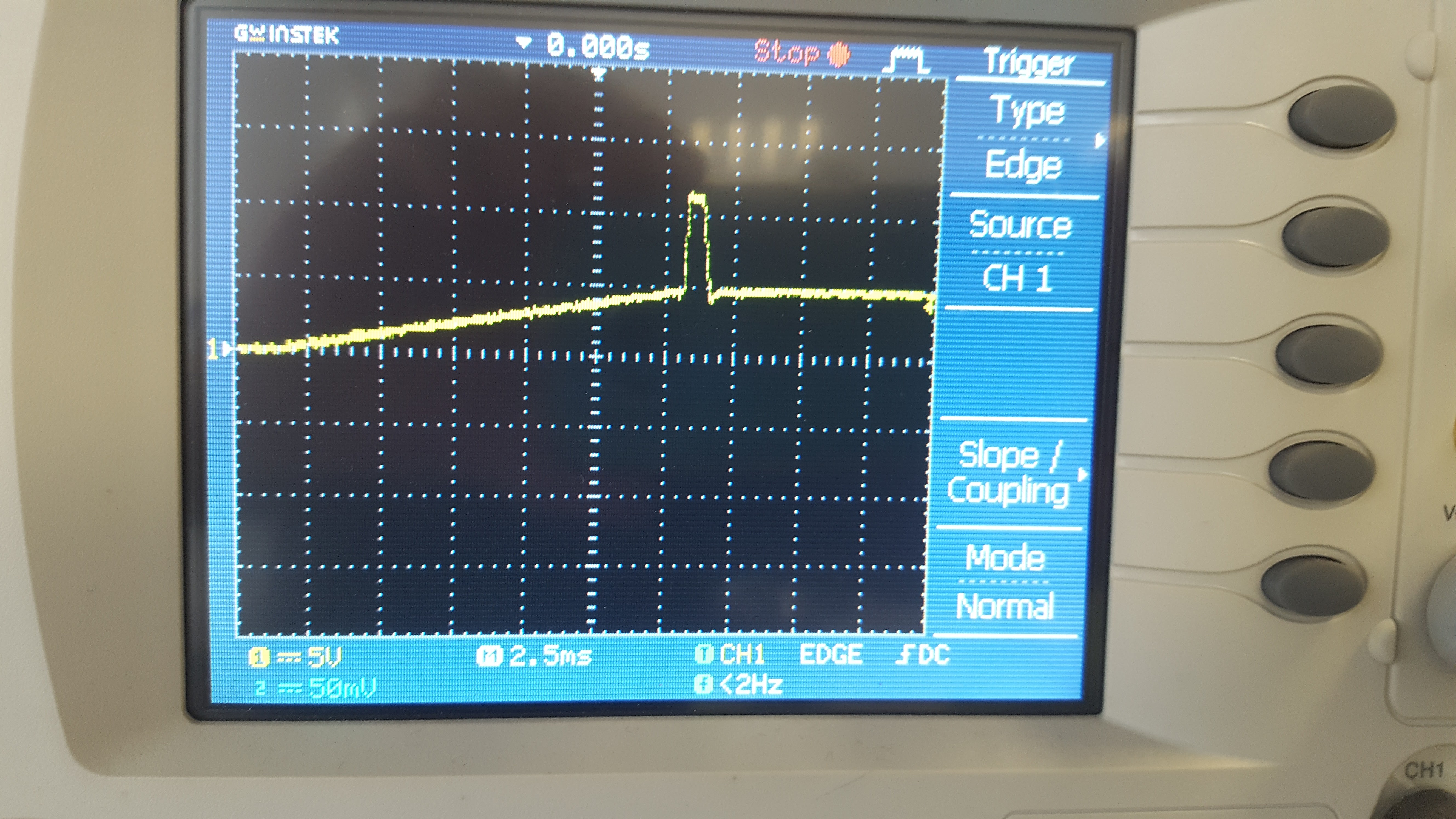

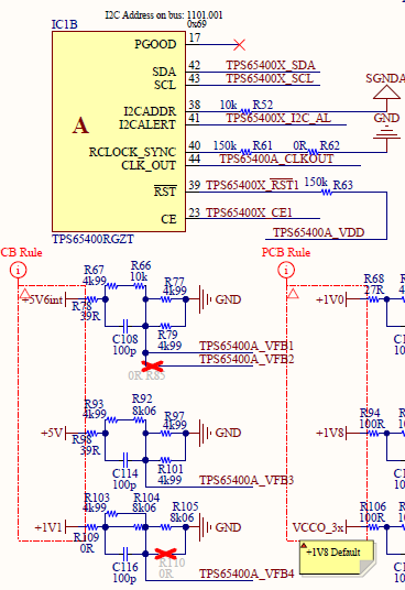

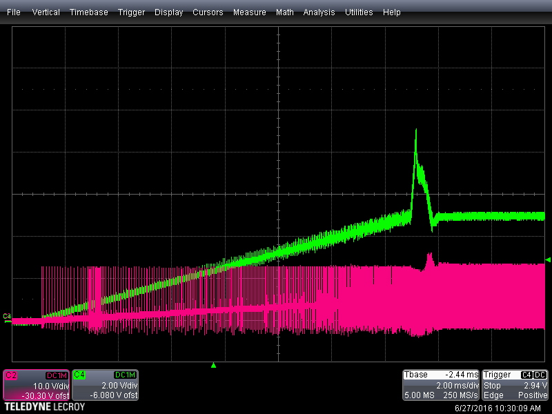

We observed a strange behavior of the TPS65400 DC/DC (full code: TPS65400RGZT) on some outputs.
At the power-up of the device, the output present a high and long (about 1ms)  overshoot ( of 12V)  instead of the set 5V:

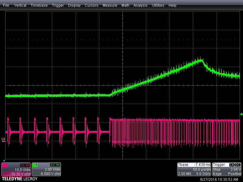

Here it is the zoom of the  overshoot:
Do you have any idea how to fix the problem?
