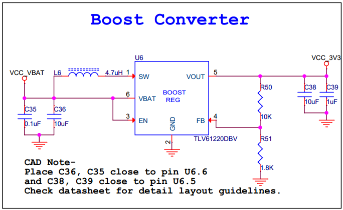

I'm unable to understand what does it mean by "Minimum Switching Current 200 mA"? Will the IC take minimum 200mA to provide the desired output?
I am going to drive the IC using CR123A (1550mAh) and can give up to 500mA max at a time. Input voltage for the IC will be 3V when cell is fully charged.My output requirement is -
Vout- 3.3V
Iout- 50mA
I am sharing my schematics-
Can anyone please let me know if i'll have any issues to get desired output?
