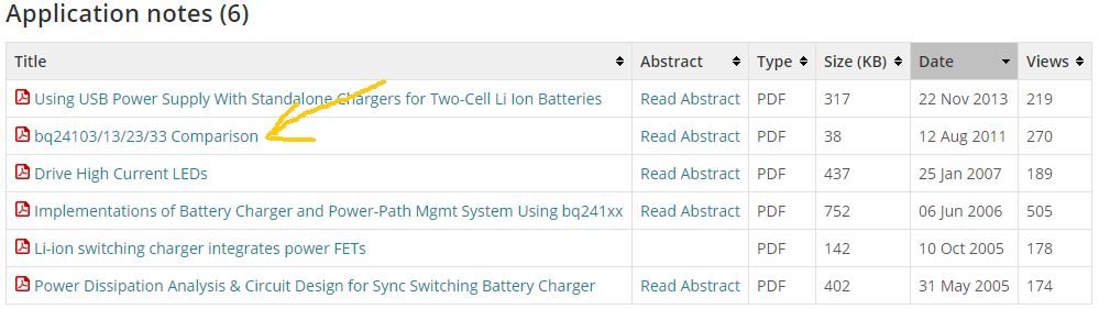

  • www.ti.com/.../slua603.pdf
    You can also refer to this comparison application note on the differences between those three device.
  • Jing Zou ni hao,
    Thank you very much for pointing me to the application note! That helps a lot...
    And mea culpa for not having seen it on the products documents page... information overflow!
