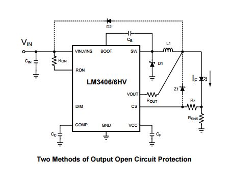

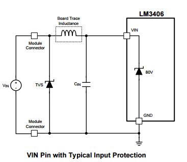

There is the output protection and input protection schematics example in the datasheet.
Are there any recommended parts of D2 and Z1 on the output open circuit protection and TVS  on the Typical input protection?
For output, Vf is about 1.65 to 4V, ILED is about 1.5A.
For input , specifications are the following.
VIN = 6V (cold-crank)
VIN = 9V to 16V (nominal)
VIN = 28V (2 minutes, double battery jump start )
VIN = 40V (300 ms, load-dump)

  • HI Asaka-san,
    The reason D2 is suggested is in the event and LED breaks open and there is no output capacitor, this would help to absorb the built up energy in L1 back to Vin. So this has to be sized to handle your peak inductor current. The more critical piece of protection is Z1, Here the current should be rated  to be able to continuously handle IRZ + IRSNS + ICS. Please note that the Maximum RZ recommended is 1K. The smaller the RZ, the lower the impact on LED current accuracy. So Z1 should be rated for the worst case load-dump and the total current.
