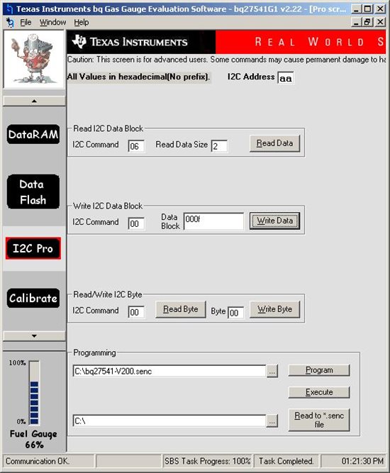

    For your reference, this is how to upgrade/downgrade the firmware:
    1. Go to the I2C Pro window.
    2. Send the device to ROM mode by entering ‘00’ into I2C Command, ‘000F’ into Data Block, and clicking ‘Write Data’
    3. Go to the ‘bq275xx Programming’ box, and browse to the SENC for the firmware you want to program.  All firmware SENCs are available on their respective product webpage on ti’s website.  Click ‘Program’, and ‘Execute Program on bq8032’
    4. Restart the Evaluation Software to recognize the firmware upgrade.

  • Hello
    I've just tried following these instructions to change the firmware version on the bq27500 device on the HPA291 rev B board that is supplied by TI with the EV2300 module. The firmware version is 1.08 (as supplied) and I wish to change it to 1.30, to make it compatible with the version contained in my project's production boards.
    So, I executed steps 1. and 2. according to the instructions. However, at step 3. , I select the .senc file but when I click on 'Program' an error message box pops up saying: "Comm. error code = 772".
    What does this mean and what might be a likely cause?
    Other info: the HPA291 board has a fully charged single cell LiPo cell attached, and it is still possible to communicate with the bq27500 device afterwards (updates on the DataRAM screen still work)
    Thank you
    Jeremy
  • Hi Jeremy,
    The cryptic "772" error code means there was no I2C response to the target address.  When you are trying to program the SENC it should be in ROM mode so the target address is 16 (as opposed to AA when in FW mode).  Most likely you left it in FW mode before clicking Program.  Be sure to follow all the steps in the app note.  I suspect you forgot to Write I2C Data Block 000f to I2C Command 00 which sends it to ROM mode.  Make your screen look like this picture and click Write Data.  Then program your SENC.  Then click Execute to run the FW when the programming is done.
