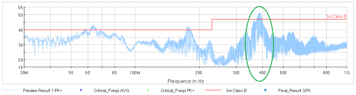

I've successfully implemented a LM25118 buck/boost converter in order to set an output of 16V and drive a load of 200mA. However I'm facing a radiated emission issue around 400MHz as shown

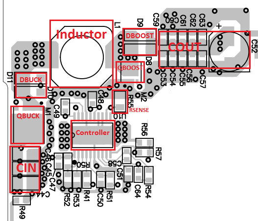

During the layout stage I've followed the datasheet guidelines and this is how it's done currently (top layer).
Seems that everything is okay but I don't know where the problem is.
How can I avoid this radiated interference?

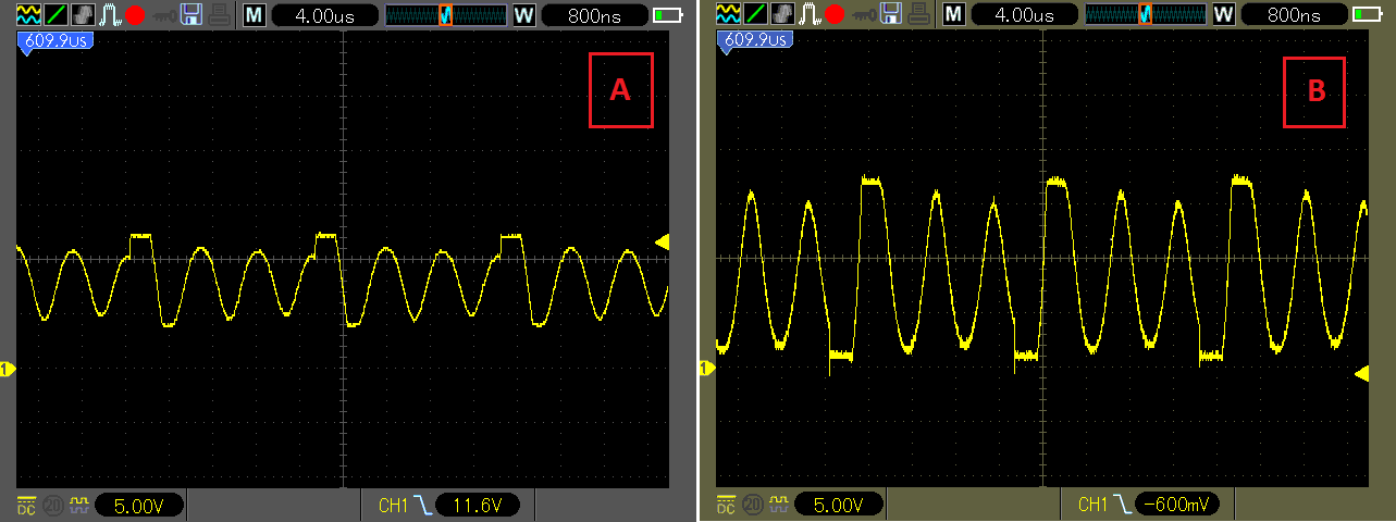

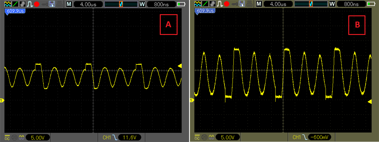

    At the moment here's the node A and node B measurements (no load condition)

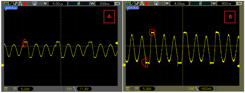

    Can you zoom in on the waveforms you captured? I've circled the areas I would like you to focus on. There is usually some ringing on switch node in the frequency range you are seeing.It is usually small in amplitude and is caused by parasitic capacitance on the switch node.

  • Hi Garrett,
    The observed ringing is about 200MHz. I'm not sure if it's the expected value (f_interf = f_ringing x 2) or it's caused by my oscilloscope limitation (BW = 200MHz). Anyway, how can I mitigate this ringing? Can I implement a snubber network? Where exactly? I think the section 9.2.2.16 in LM25118 datasheet does not clarify this enough.

  • That's great Garret! The ringing has decreased as shown with a 680pF and 1R snubber network
    Now I just have to perform EMC tests again
