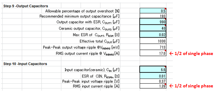

Hi Team,
Our customer are evaluating the dual phase of LM25122.
Therefore, we would like to know the value of external components (Loop , slope, etc)
Could you please send the calculation tool of the external components to me if you have any information?
And, I have one more question.
Is there any concern if they set “Vout=48V”?
We understand that the recommended switch node voltage is 50V(max).
However, they worry about margin of the switch node voltage.
< customer requirements >
-Vin=12V(typ)
-Vout=48V
-Iout=around 8.5A (Pout=400W)
