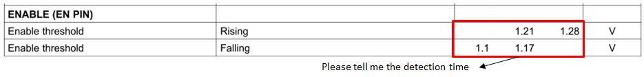

Could you tell me the detection time of the EN?
Customer want to know it in order to determine the rise time of EN.
Yusuke/Japan Disty
hello,
EN has internal anti-noise hysteresis, basically no concern for EN rise time. We ever used very slow rising speed like 0.1V/mS to test this device, no issue at all
regards
