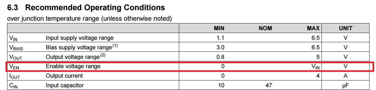

TPS7A8500 sequence requirement
According to datasheet, supply and enable sequencing is only required when bias rail is present.
Is there no problem that enable becomes high before VIN is supplied when bias rail is not used?
And Is it OK that VIN and VEN are added before BIAS rail when bias rail is used with the following condition?
VIN: 2V
VBIAS: 3.3V
Vout: 1.2V
