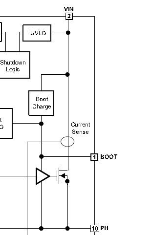

I have noticed that I could improve TPS54260 low dropout improvement by the following solutions:
Solution a. Diode tied from input to BOOT
Solution b. External voltage at BOOT
My questions are:
1. What is the function of internal "Boot Charge"? Is it a LDO? What's the difference between "Boot Charge" and solution a?
2. Is there a maximum external voltage limit when using solution b?
Looking forward to your reply!
