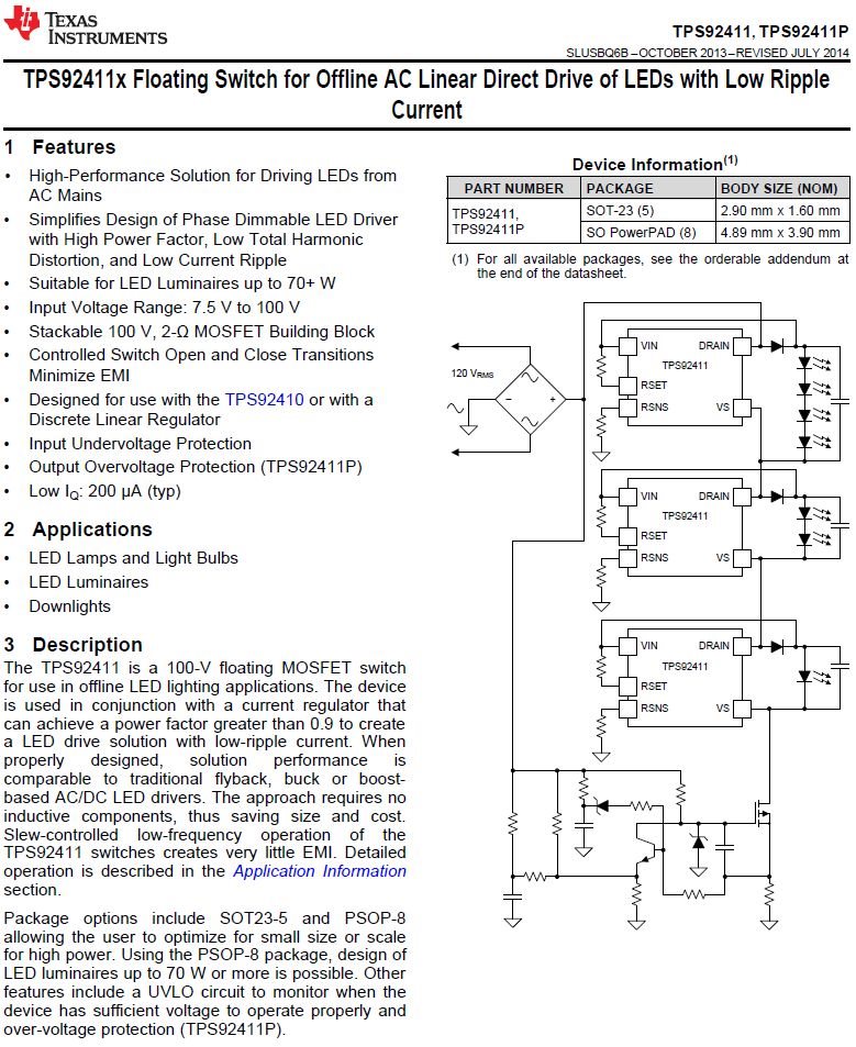

    But I used calculator from TI "slvc580", which has the note "This design is good for 1.6W to 100W of input power" and for 100W light power is approx 88W, so the peak power is approx 88W/240*1.44 = 0.52A
    This is correct? Or in this case we must to use SOIC package? Which current limits for SOIC?
    We need to implement 100W of light power module minimum...
    The front page of the datasheet states 70W or possibly more in the features and further down in the description (this is for both TPS92411 packages).  We didn't intend to go beyond 35 watts at 120 VAC and 70 watts at 230/240 VAC.  The peak current at 100 watts input will be 100W/240 VAC * 1.414 = 0.59A.  The efficiency is mainly lost in the current regulating MOSFET, that current still runs through the TPS92411s so it needs to be calculated with input power not output power.
    There really isn't a current limit for the TPS92411 however it will begin to hard switch if the current gets too high meaning EMI will go up significantly.  If I recall this limits the  useable current range to 500-600 mA.  You can try to do this but will most likely have to use the SOIC and heatsink it fairly well.  There is more than conduction loss with this part due to slew rate control.  Even though there are only a few switch cycles per half line cycle the transition is slow which results in switching loss.  You can watch the slew with an oscilloscope and calculate the power loss from that or use the datasheet values for slew rate.
    An example would be TPS92411 open loss per switch cycle on the 80 volt stack.  Slew rate is 0.5V/uS so 160 uS to transition.  At 120 Hz this duty cycle is almost 2% for this one transition.  The TPS92411 close switch loss will be half due to the slew rate being 1V/uS.  Average power dissipated during the open switch slew would be 80V * 0.5A / 2 (/2 is because the voltage is slewing from 0 to 80) = 20W.  At 2% duty cycle this is 400 mW for that one transition.  Add half again for the close loss and it's 600 mW.  There are two on/off cycles on the 80 volt stack though the current during the other two transitions will be lower.  Add to this the RDS on loss the part will have to dissipate over one watt.
    The cascode MOSFET for the 160 volts stack will have to increase in size as well.
