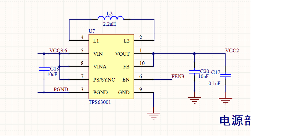

dear:
i have a problem of en pin to control the tps63001 to output.
i want to implement the function as follows:when the en pin is high 3.3v,the output will be 3.3v,when the  en pin is low as ground,the  the output will be 0v
but i build the schematic as follows:
but when the en pin contact to the ground ,the output will be falloff from 3.3v to 0v,and the time of falloff is about 10minutes
